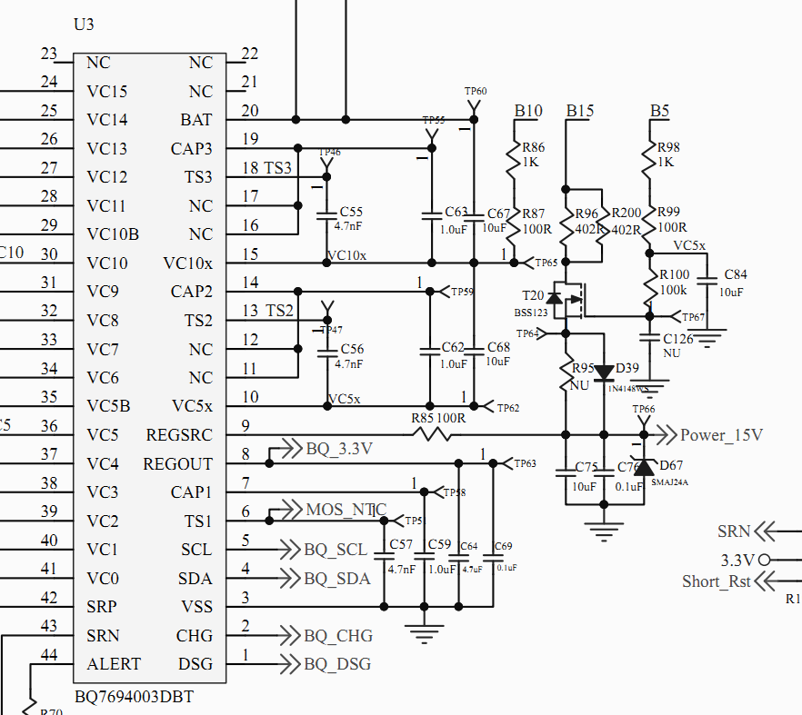

BQ76940: Question about BQ76940 "OR" supply on "REGSRC" pin
Part Number: BQ76940

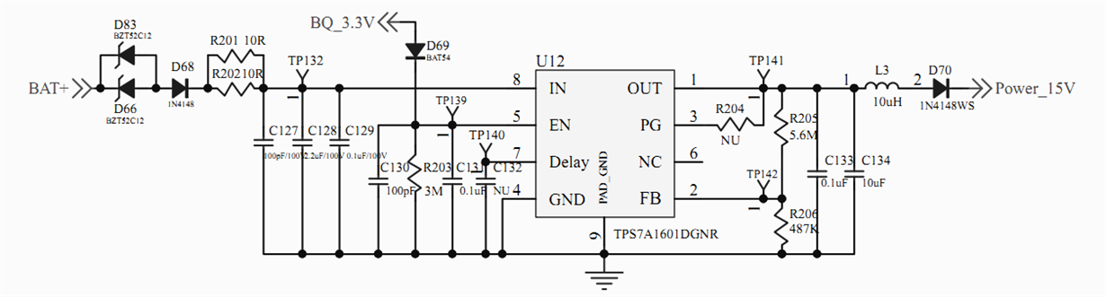

An question about the power supply for BQ76940 on the PIN "REGSRC". I want to use two source as the supply on this PIN, one is using a FET referenced to the VC5X voltage as a source follower, and another is using a external regulator with 15V at the same. Using "diodes" for these two source as below picture. Please help check whether it is ok for this chip.
