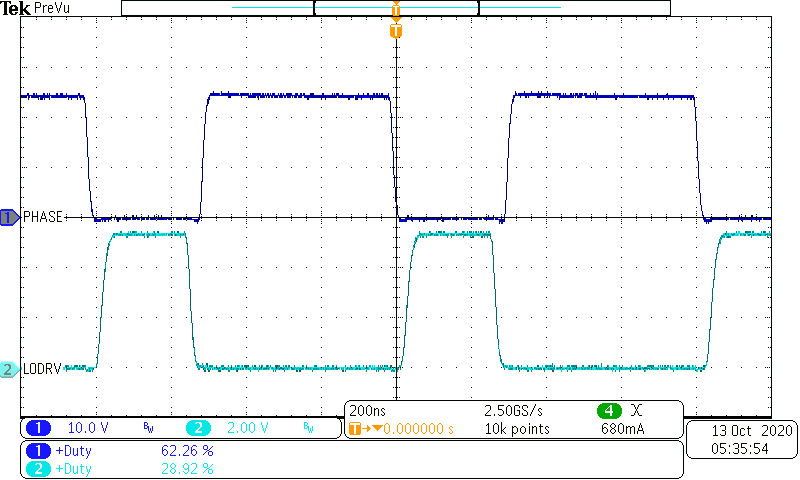

    I tested this on an EVM with your operating conditions (CELL pulled high, VBUS = 24 V, ChargeCurrent() = 3 A, and ChargeVoltage() = 15 V). However, I'm unable to duplicate your issue. HIDRV and LODRV are both switching. The waveform below shows the PHASE node and LODRV.
    You're testing this on a BQ24770 EVM, correct? Can you share your register settings and waveforms? Also, can you try other ChargeCurrent() settings to see if LODRV is always low?

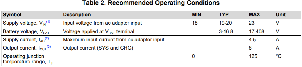

    Lastly, I would like to point out that a 24 V input is outside of the EVM's recommended operating conditions, as shown in the table below. It is not recommended to exceed 23 V.

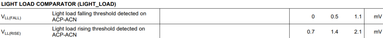

    Thanks for sharing your observations on the EVM. Your description is consistent with the BQ24770 operating in light load. Since ACP and ACN are shorted, the voltage drop across ACP-ACN is lower than the light load threshold:
    The following E2E thread discusses the exact same behavior, where ACP and ACN were shorted together, causing the LSFET to never turn on:
    https://e2e.ti.com/support/power-management/f/196/t/763786
    There is no way to disable the light load comparator, so I think you will need to add the Rac input current sense resistor in order to avoid this behavior.
