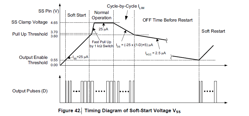

    I think the PSU is operating in Hiccup mode. This is the normal, expected response to a current overload and is described in the data sheet. The easiest way to confirm this is to probe the SS/EN pin during the overload. You should see it behave like this. Yel:CS Grn: OUTD Red: OUTB  Blu: SS/EN.
    Hiccup protection reduces the average dissipation in the PSU and this is why it is the default behaviour for this controller. It's possible to force a Latching OFF or Continuous operation in Current limit if you wish to - let me know and I can supply the details
    Colin

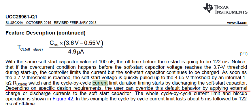

    Brief details of how to implement continuous operation are given in the Data Sheet.

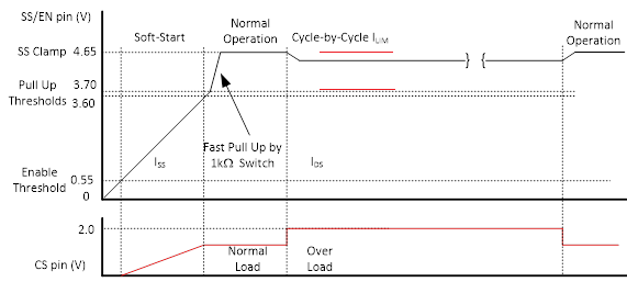

    In practice, to give continuous operation in current limit you should place a 180k resistor from SS/EN to GND and a 12k resistor from SS/EN to VREF. The effect is to prevent the internal current sink IDS from pulling the SS/EN pin below the hiccup threshold at 3.6V - The SS/EN pin should be at a nominal 4.35V - or at least somewhere between the two red lines below.
