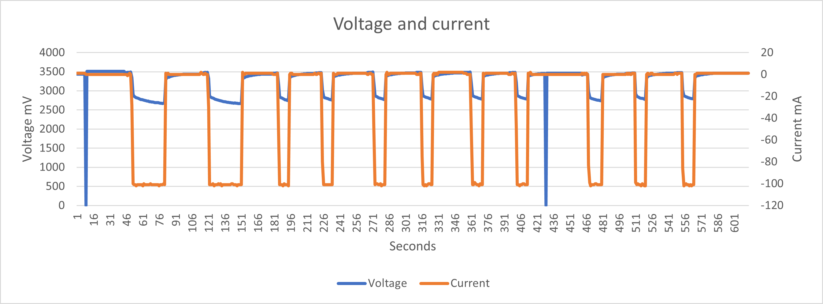

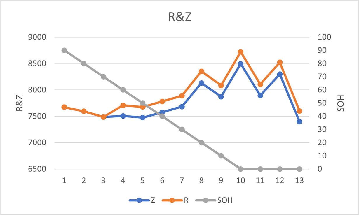

Hi Team,
We are using BQ35100, EVM2400 and BQ35100 to get correct SOH value in EOS mode of Tadiran 5920 (CHEM ID 0x0609). These are the results of Initial learning pulses after sending NEW_BATTERY Command.
1. Why SOH value is continuously decreasing? The method followed for pulses is this
2. The R and Z values are not reflecting SOH to be 0 (After looking at Ra Table). Please provide some explanation, why this is happening?
Attached: gg.csv file: Tadiran_test.gg.csv

  • Hello Prudhvi,
    Is the chemistry ID selected the exact match for the battery? In EOS mode the chemistry ID must match exactly to get accurate SOH.
    It looks like the gauge is updating by 10% each pulse which is the default maximum step size for SOH.

  • Hi Wyatt,
    I tested with another setup. The load used is a 100 Ohm resistor with a Transistor switch. I get around 30-35 mA current from Battery when the load is on. Now, the Bad_Voltage flag is low (most of the time), It goes high when I start the Gauge just after the previous measurement cycle (So, this seems fine). But there are a few issue and doubts:
    1. I am not able to get rid of the 10% drop (maximum delta) in each measurement. I am using a battery previously used and starting again each time (which might compromise my measurements). Each measurement has either SOH_ERROR or SOH_MERIT Flag high.
    2. Also, a relaxed state of the battery is a little confusing, this depends on battery to battery, as well as load conditions, right? So How do I make sure that the battery is in a relaxed state after a discharge cycle? TRM mentions 5 Hrs as a relaxation time.
    Kamlesh
  • Hello Kamlesh,
    Is the load causing a 100mV drop in the battery voltage? It looks like your first test was 100mA pulses?
    Also from looking at the logged data on your original post, did you enable the gauge for each one of those pulses? The battery voltage should be relaxed before the gauge starts taking measurements, if your load occurs every 50 seconds or so that's not enough time for the battery voltage to settle.
    You will need 5hrs relaxation before the pulse the gauge uses to update the resistance values (wen you enable the gauge). You can have other pulses that are often, but the gauge shouldn't be enabled for those.

  • Hello Wyatt,
    Yes. The load is causing a drop from ~3600 mV to 3100mV. Initially the pulses were 100mAs (Right now, I am testing with a new setup as already mentioned, it takes around 30-15 mA and causes a drop >100mV).
    Yes, my method is this. GE_ON -> After few seconds, GAUGE_START -> LOAD_ON -> Wait for few seconds (~10 secs) -> Load_OFF -> GAUGE_STOP -> wait for R, Z and SOH to change -> GE_OFF.
    For the next cycle, I wait for around 30 minutes or more. Sometimes, I turn on the GE (in between the waiting period) to measure the voltage (whether it reached to initial voltage or not). When I turn on the GE, I see a voltage value, if this value seems okay, then only I start the gauge (GAUGE_START), otherwise turn it off again (GE_OFF) and wait for the voltage to rise.
    If the turn on voltage is sufficiently high, I start the gauge (check if EOS_BAD_VOLTAGE is high or low) -> If it is low, then turn on the load and proceed for cycle to complete and measure SOH. At this stage, mostly I see SOH_MERIT or SOH_ERR high and 10% drop in SOH. I am stuck here for now.
    I see that even if I don't turn on the gauge, the time between non-gauging and gauging pulse should be atleast the relaxation time of the battery.

  • Hi Wyatt,
    The link shared by you, was really helpful. I am making the battery rest for 5 hours and then turning on the Gauge. I am continuously getting SOH_MERIT flag high. And SOH is reducing by the max delta which is 10%.
    Values of R is varying around ~9000 which is in the Ra Table. Z values are varying between 17000 - 18000. Hence, we can see that the Gauge has learned and applying the scaling factor. Now, In my opinion, there could be following problems:
     1. Because some of the learning pulses (pulses sent just after new_battery command) had EOS_BAD_OCV high. This may corrupt the scaling factor and hence SOH. Should I send a new_battery command and start the learning again?
    2. Some unknown issue with the battery. I see that drawing ~30mA current  leads to 600 mV drop and after that it starts rising again. Can this hint toward a malfunctioning battery?
    Thank you so much for your support.

  • Hello Kamlesh,
    The SOH_MERIT is still being triggered so the voltage still may not be relaxed enough, there is some kind of discrepancies between the Z and R values because the voltage is increasing during the sample.

  • Hello Kamlesh,
    Yes you can generate your own Ra information by discharging the battery and at each of the Ra grid points (the DOD at each point) measure the resistance value yourself from the gauge, then you can program your own batteries Ra information to the gauge.
    The first 7 grid points are every 11.1% and then it is 3.3% until the final DOD. Then the gauge would be customized for your battery.
