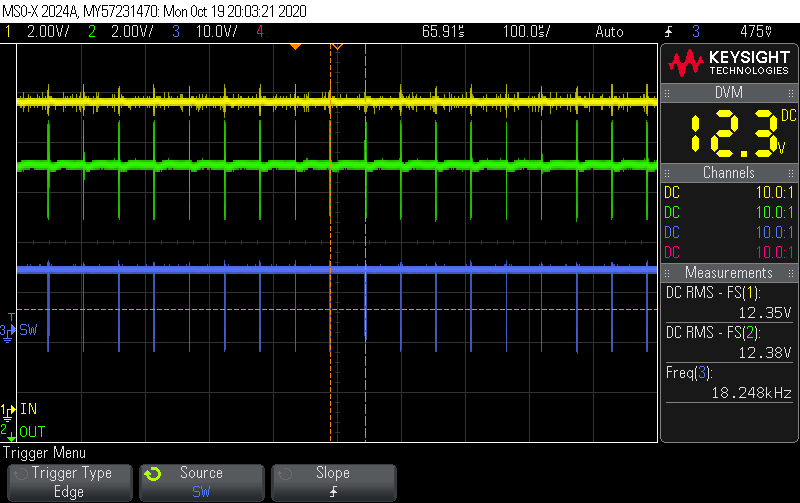

Switching frequency at SW is around 15kHz on one unit and 18kHz on the other.
Vin and Vout are stable and both LMZM23601 are cool to the touch.
Adding a 1k load on the output does not change Vout.

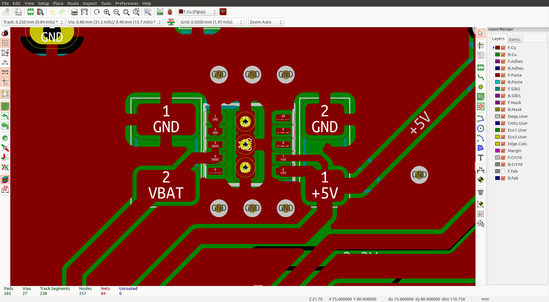

PCB layout. PG is not connected.

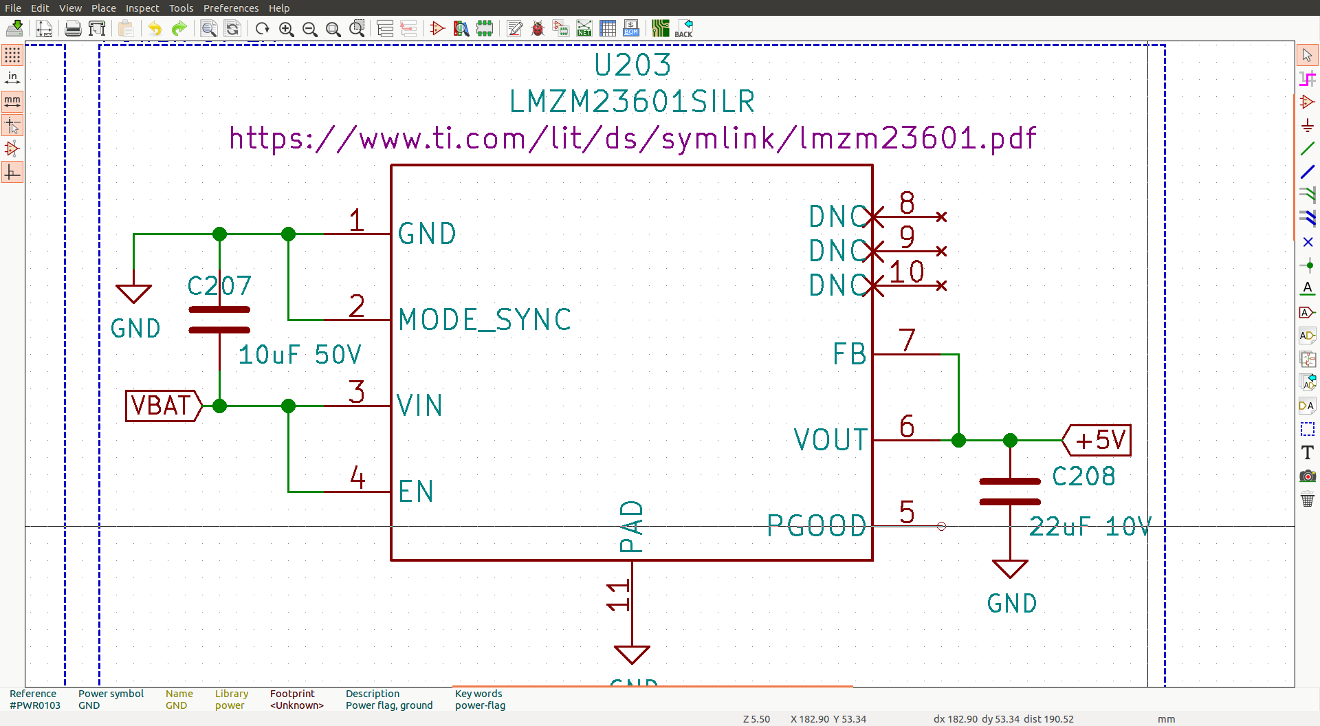

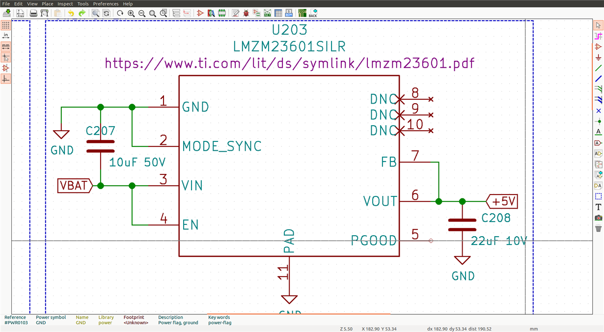

Relevant part of the schematic
Yellow=Vin / Green=Vout / Blue=SW frequency
What am I doing wrong here?

    I don't see anything obvious that you are doing wrong.  It almost looks like the FB pin is not connected to the VOUT.
    You could try to check continuity between FB and VOUT, even though your PCB snapshot shows a connection.
    Also, be sure that the FB pin is soldered correctly.
    I will consult with our module group to see if there is anything else to look for.
  • With the module in place, I can't really check the continuity between FB and Vout as the pads aren't accessible under the LMZM. I've tested the continuity on blank PCBs and the pads are connected.
