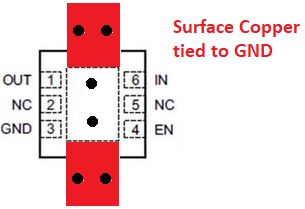

Hi Jason,
Yes the WSON package will be a better choice and we would recommend placing as many thermal vias from the ground pad to a ground plane as you can fit. 2 vias are shown here but if the fabrication house you will be using can fit 3 or more vias, that will offer you better thermal management and improved MTBF. Additionally you can extend the ground copper on the same layer as the components are placed and add thermal vias from the surface copper as well.
