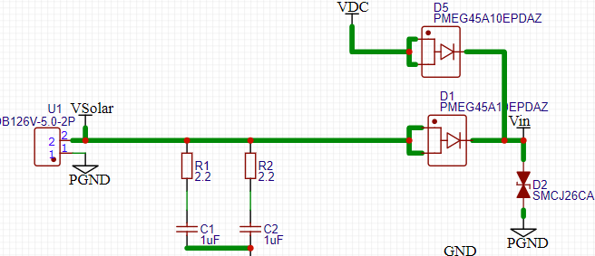

I was looking at possibly providing a backup wall outlet 9 V DC wall adapter to be plugged in at Vin before D1 and D2 and have both power sources separated by a mechanical slide switch to switch between solar panel and wall outlet charging. Here is the schematic to better understand what is discussed:
The MPPSET will now be 1.717 V (not 1.2 V)  due to this. So will it be sufficient or feasible to connect a two-way switch leading to either the solar panel or wall adapter sources to Vin before D1 and D2 found above??

  • Hi Ibrahim,
       Yes, this is feasible. When using a DC supply in conjunction with a solar panel, the key is to have the DC power supply voltage higher than the MPPSET 1.2V regulation point. Alternatively if OCV of solar panel is < DC adapter voltage, you could just use a simple diode OR configuration at the input side, so that wall outlet is always preferred when connected.

    I'm glad to hear that! As for the diode configuration, are you suggesting I implement something like this at the top left side of my schematic??
    Having 9 V for VDC and 7.4 V OCV would mean that no matter the solar exposure on the PV, the input of my design will always be VDC correct??
