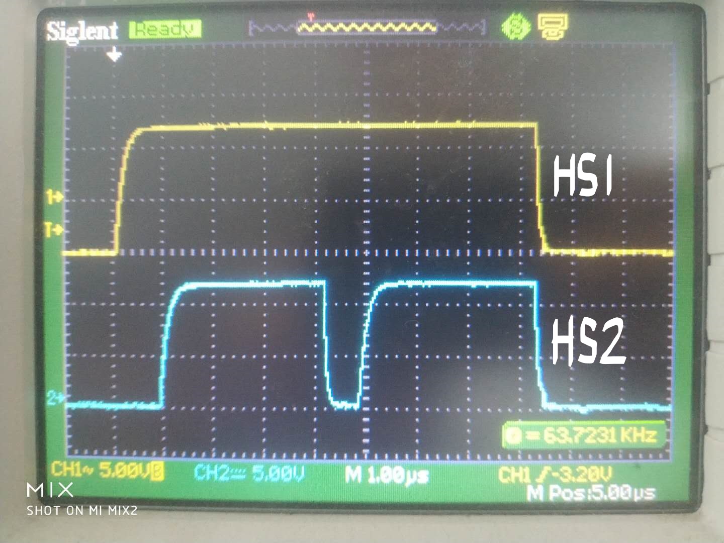

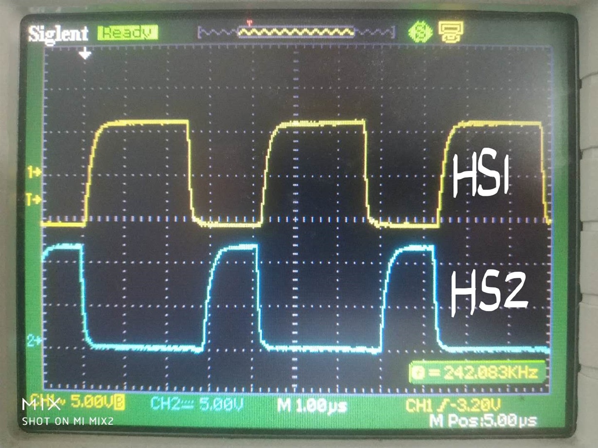

    I had  checked the FAULT[2:0] pins, The measurement is [000], It means no FAULT.
    I've also measured waveforms on an oscilloscope,
    Below is the waveform of the HS1 and HS2 when open discharge:
    Below is the waveform of the HS1 and HS2 when open charge:
    The waveform of discharge does have a problem by the results, but I don't know why.
    In addition, I'll describe the phenomenon again : when discharging, the Secondary Side(cells) is already consuming energy,but Primary Side is no power.

  • Hi Jun,
    It's interesting that you are not seeing any fault in the device. The discharge signals do look different than expected. Since the device is not triggering a fault, I would recommend to focus on the board components or any traces/connections that might be different between your new board (not working board) and your older version of the board (working board) by testing both. I recommend to compare the signals on both working and non-working boards to find any differences and trace the problem that way. You can use signals on figure 7 in the datasheet as to how the 4 signals (GATE_LS, GATE_HS1, GATE_HS2, PWM_CLAMP) need to look when discharging.
