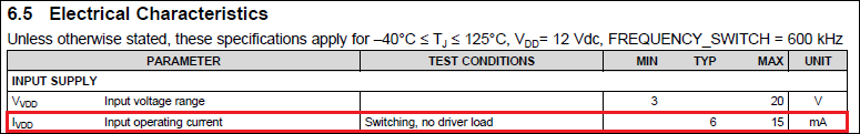

Would you advise does TPS40400 have power saving internal register setting or
external part which can save power?
My customer want to reduce Ivdd below to less than 4mA which is required by product.
Any advice should be highly appreciated.
Shidara
    No, the TPS40400 does not have a low-power function that would reduce the VDD current to 4mA.
    If they do not need PMBus Telemetry, we have alternate devices that are able to support a sub-4mA VDD bias current.
    Please see the TPS549B22 and TPS549D22 for examples

    The customer is designing based on PMP21440 https://www.ti.com/tool/PMP21440
    And currently TPS40400 Ivdd is exceeding the product requirement.
    So if TI have another recommendation which switches around 1MHz and lower Ivdd<4mA,
    and can drive LMG1210 correctly, it will be very much appreciated.
