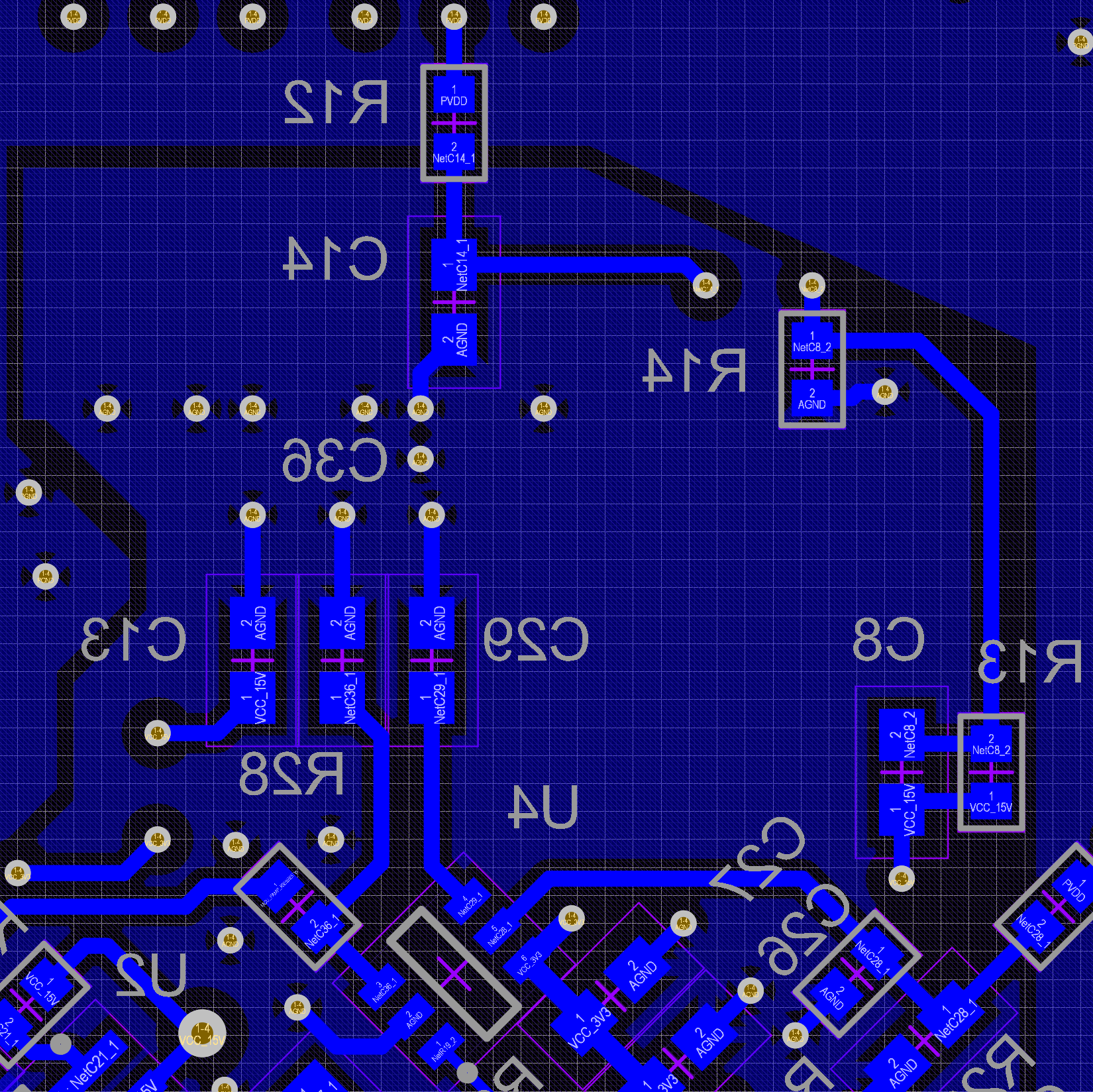

Can you please share your schematic and layout for this?
Harrison Overturf
Hello Harrison,
Here is our schematic
Note: not shown in the schematic is a 10k resistor in parallel with C14. This component was present in the scope captures posted earlier and was added to keep the regulator off until the PVDD supply was >= 15V. The issue persists when the 10k resistor is not present.

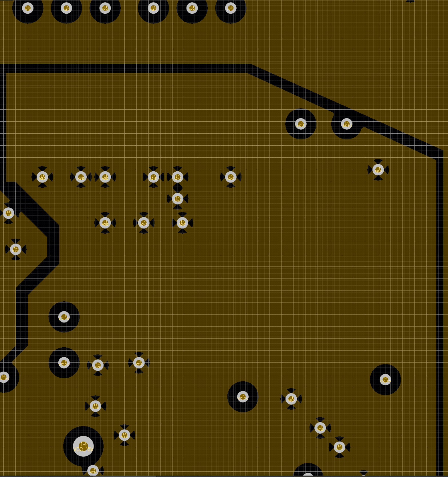

Top Layer:
Layer 2
Layer 3
Bottom Layer

Thank you for sharing the layout and schematic.
I have a few tests that you can run to see if the performance improves:
Let me know if any of these tests show any improvements in performance.
Harrison Overturf
