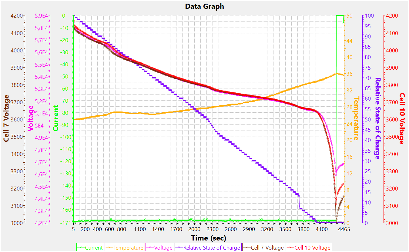

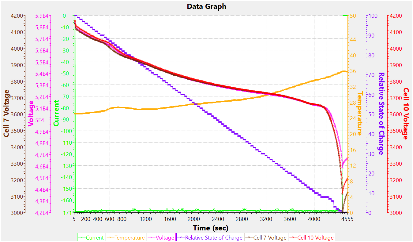

    Anyway, I've run a test with these parameters setting EDVR1=65535. During the 1rst discharge there's a RSOC jump from 12% to 7% (calculated EDV2=3676mV). This EDV2 point is above the "knee" of the discharge curve and it affects to the new calculation of FCC which becomes updated to 1,96Ah. The nominal values of these 14 cells that I'm using are 3,7V and 2,1Ah.  Later, the calculated EDV1=3653mV and EDV0=3598mV. So, the batteries remains at 0% too much time until UV occurs at 3V.
    Questions:
    1. After introducing the parameters, adjusting "Dod at EDV2" and executing a reset. Is it required a complete cycle from "fully charged" to "fully discharged" to update FCC and obtain in the next discharges a better RSOC% calculation? Is it mandatory for a good RSOC%? I'm wondering if this process should be added in the future production process to send batteries with good RSOC% estimation.
    2. How I could improve the RSOC% results explained before?

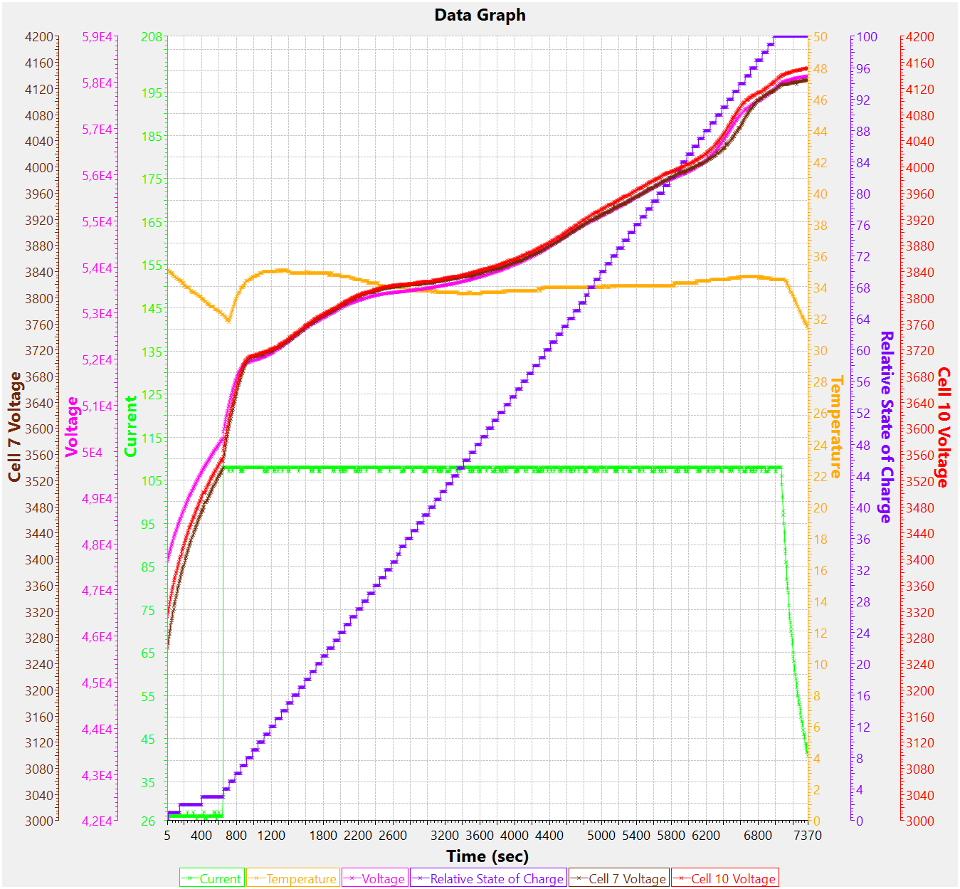

    Enclosed you can find data graph of the discharge and charge process.
    Marco.
  • Marco,
    you are correct that the value shoudl be limited to 2^16-1, this normally happens naturally but this battery is has unusuall high impedance.
    Anyway, I was able to re-fit the values with limiting the max, and get a good fit. Try using attached parameters.
    To you other question - CEDV only learns at EDV2 threshold, so it is expected to have a jump at first discharge cycle, or if temperature or rate conditions have
    changed. Some customers to implement learning cycles in production to learn FCC to reduce initial jump, but as I mentioned, change of temperature conditions will change a jump as well, so learning is only justified if yo also like to use learned FCC for some quality  control purposes.
    Unfortunately it is not normal behavior for CEDV, and you would have to go to an IT gauge to make adjustment of FCC happen earlier.
    Yevgen

  • Hi Yevgen,
    Thanks for your response.
    I've tested the new values and they are quite acceptable. But I've seen that the calculated EDV0 = 2943mV which is lower than UV = 3000mV. Is there any problem if EDV0 < UV ??
  • Hi Marco,
    Normally the under-voltage threshold is significantly lower than EDV0 (the default is 2500 mV). It is okay if it is higher, but the protection will trigger before the SOC reads 0%. Since FCC learning takes place when EDV2 is triggered, it will still learn the new capacity as the battery ages.
    Matt
