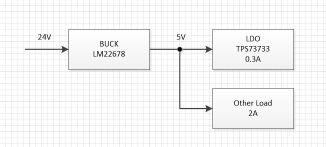

  • Hi Stephen,
    1. What is the maximum capacitive load of TPS73733? The 5V power supply in the picture has two loads, one is 0.3A and the other is 2A. The output capacitance of TPS73733 is relatively large. When the voltage of EN pin is greater than 0.5V when power is off, the capacitance may be discharged through TPS73733, which will cause the chip to fail?

  • Hi Stephen,
    1. Do you have a way to limit the reverse current to 50mA? The 5V in the circuit has a large 2A load. When the system is powered off, if the 5V power is consumed faster, the 3.3V load capacitor will discharge the 5V power, and this current is not easy to control.

  • Hi Rengui,
    Question 1:
    The reverse current would be limited by the application circuitry, the LDO would not be limiting the reverse current. You typically need to insert some new component or small circuit to perform this function. A series schottky diode in front of the LDO would be enough to limit the reverse current in all cases.
    If you are using a resistor divider on the EN pin from Vin then you meet the datasheet criteria of driving the EN pin low before removing Vin.  In that case you do not need any additional components as the device will always provide reverse current protection.
