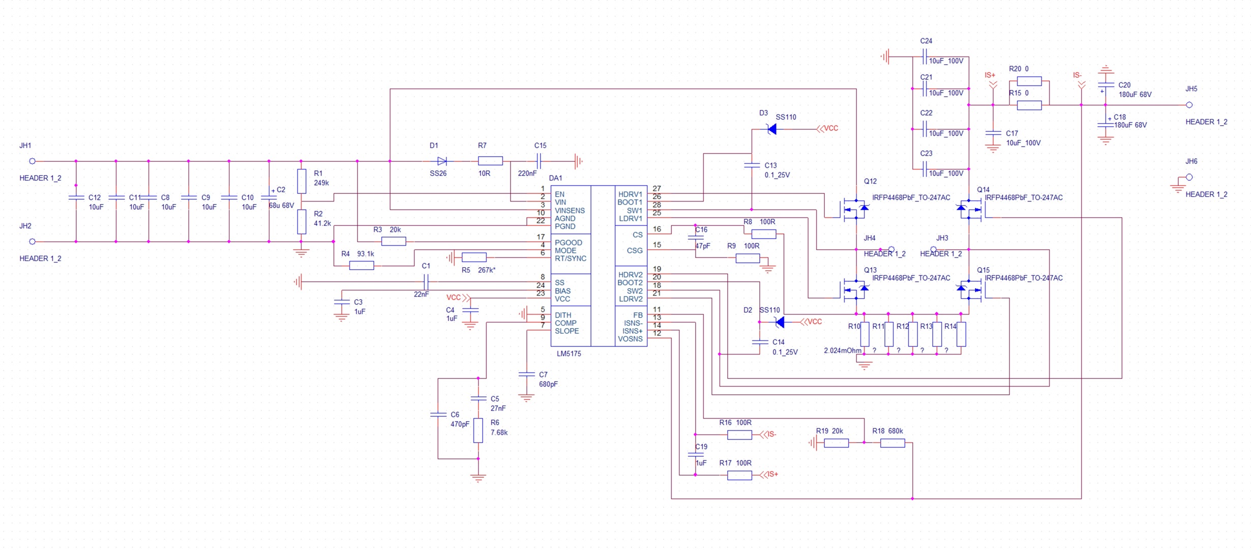

WEBENCH® Tools/LM5175: I can't start the circuit ... No generation.
Part Number: LM5175
Other Parts Discussed in Thread: LM5176, MSP430FR5972, CSD16321Q5, CSD18563Q5A, LM25122-Q1, LM5122ZA,
No generation.
the scheme that Webench squeezed out to me is complete nonsense, does not correspond to the scheme that the "initial installation" of Excel tables from TexasInstruments does.
See attachment.
What to do ?
Please, Just don't advise me to use Webbench!
I am interested in the answer from real people who made power supplies on LM5175
What is my mistake?

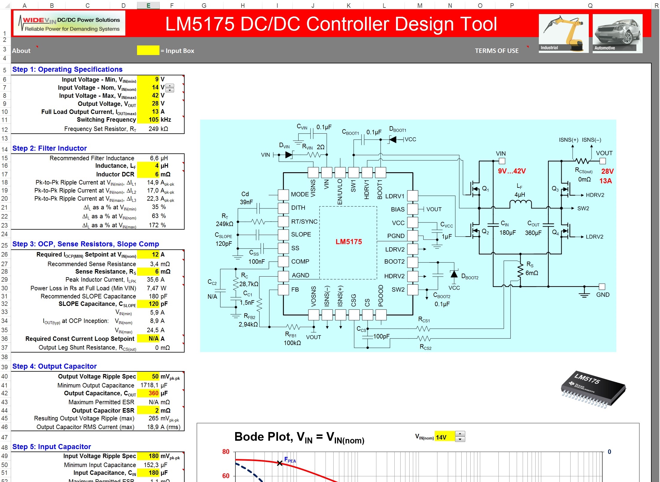

 LM5175 Buck-Boost Quickstart Tool -- r9.pdf

    3) I would apply the word "delirium" to what Webench generated for me. But my circuit also has minor bugs, which I fix. In the attachment - the SVG file of the electrical circuit that Webench made for me for currents of 15Amps = (WBDesign15) And what he did for currents of 6Amps Pay attention to Dboot diodes and D2. Now compare this diagram with what the LM5175 Buck-Boost Quickstart Tool produces. Crazy ...
    4) Why do you need to energize the Pgood leg? After all, this is a transistor that is turned on by the internal logic of the microcircuit. If I do not use this signal, then why put a 10-20kΩ resistor on it and connect it to the + power supply? This makes no sense.
    5) I did not find an answer to the question: can the LM5175 microcircuit operate at frequencies less than 100 kHz from an external signal generator?
    6) I think that my problem is that the LM5175 cannot swing the electrical capacitance of the control electrode of the field-effect transistors that I used. Now I am doing experiments with different components, I will publish the final working circuit here (if I can get the LM5175 to work).
    7) I really like some Texas Instruments products (especially MSP430FR ...), but your descriptions (datasheets) make my brain boil :)
    WBDesign6-15.zip
  • Here is an oscillogram of the real operation Gate of the Q12 transistor (my circuit)
    and the WBDesign Gate transistor M1 - (WBDesign circuit).

    6. Please use the quickstart tool for checking which components cause which power dissipation. It is for sure not perfectly matching with reality, but at least it is a good starting point, I think.

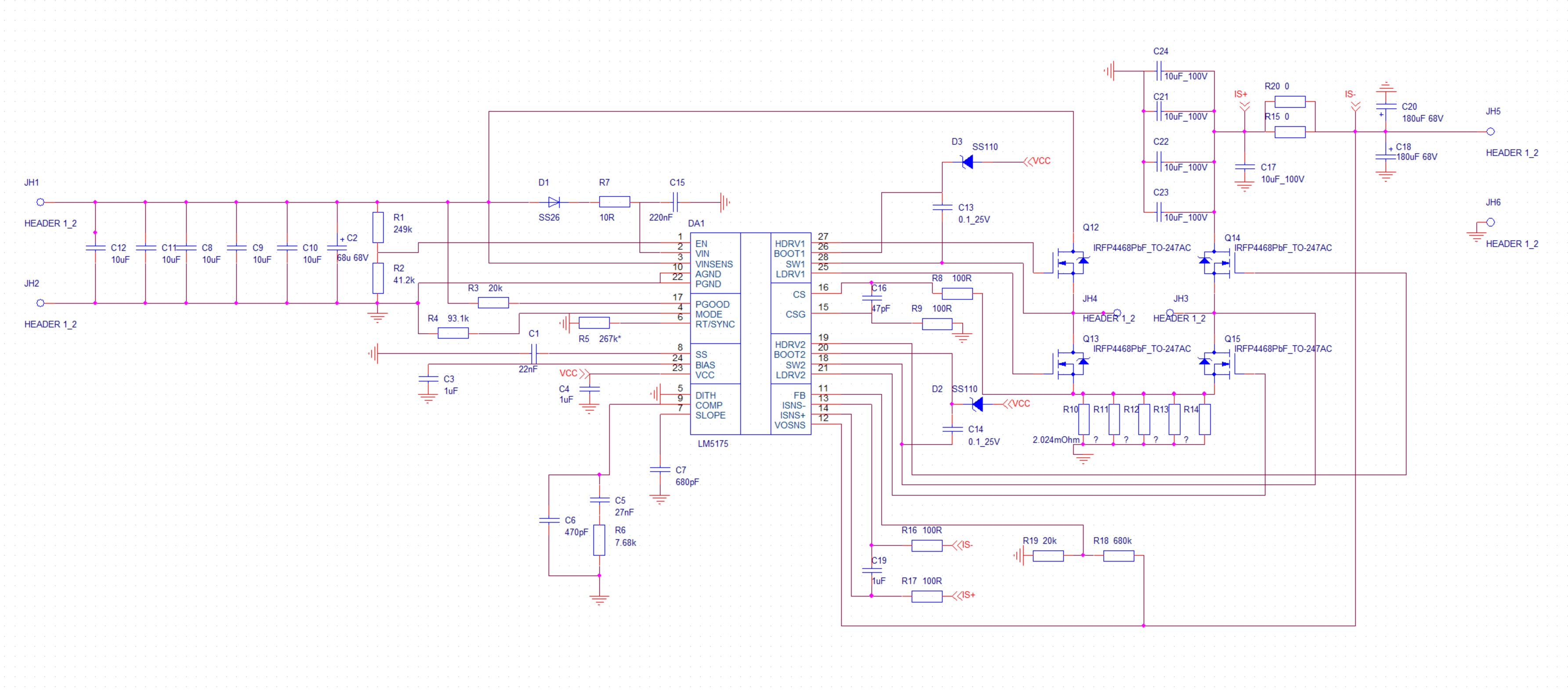

    1) I completely redesigned the PCB. See the picture.
    I used the recommended field-effect transistors manufactured by Texas Instruments.
    2) Q1 + Q2 according to your scheme are CSD18563Q5A, the second pair is CSD16321Q5
    3) When the circuit is started from a 12volt input battery, a strong whistle is heard from the inductor (inductance), the light bulbs in the load (I used incandescent bulbs as the circuit load) start to light up slowly, the Q1 transistor heats up to a high temperature. The circuit cannot reach an output voltage of 28v ... The oscillogram of the control of the Q1 gate (between pins SW1 and HDRV1) is shown in the picture Q1-Q2. As I understand it, the Q1 transistor heats up because it cannot fully open (3.2 volts on its control instead of 8.5 volts like all other transistors). Why is that ?
    4) when the transistor Q1 burned out and became completely "conductor" (its resistance in the open state became equal to zero ohms). The circuit works great and gives me 28.2 volts out!
    5) what's the problem? I have completely assembled the circuit as recommended by your program. I used the required transistors. Why does Q1 burn out?
    I understand that now my whole circuit works as a step-up, and after the combustion of u1, the circuit will not be able to work as a step-up.
    I need an input voltage operating range of 9 volts - 42 volts.
    What should I do ?
    LM5175 Buck-Boost Quickstart Tool -- r10.pdf

  • Hello Alexander,
    Sorry for the delayed response, I was out of the office during Christmas season.
    When you mention that the circuit works perfect as soon as the first transistor burned out, I expect you are speaking about Q12 in your schematic and you are testing with the input voltage being lower than the necessary output voltage.
    In addition, you mention that the behavior is the same when there is resistive load on the output and no light bulb. Can you please check the startup of the circuit when there is no load attached? Does it then start to 28V? Is the transistor then still getting hot?
    With this high current and power, I recommend to replace Q12 with 2 transistors in parallel to split the power dissipation in it.
    You are using 6 mOhm sense resistors in your layout (5 times 30 mOhm) (your schematic shows 2.024 mOhm), with 6 mOhm, the maximum current allowed through the transistors is too low for your maximum output current. This means that the converter is permanently operating in current limit, if you draw 13A. So it cannot achieve 28V.
    In step 3 of the quickstart tool, a IOCP of at least 15A needs to be set for your application, so a sense resistor of maximum 2.8 mOhm is recommended.
    Please review this article for the connection to CS and CSG:
    Other Parts Discussed in Post: LM5175 In my last blog , I provided tips for optimizing hot loops in a buck-boost converter. I decided to add this tip as a separate topic after finding it in almost all…
    Please reduce the slope capacitor to 120pF maximum for the first tests. Smaller cap there makes the power supply normally more stable when in buck-boost mode.
