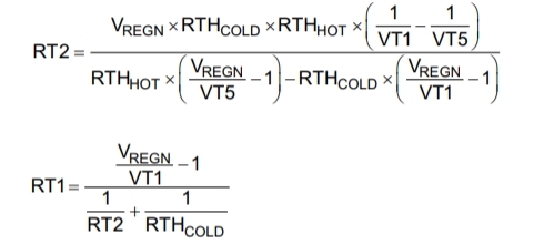

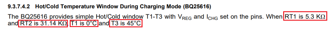

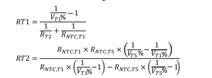

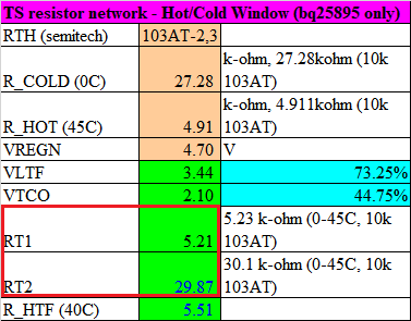

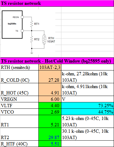

Dears,
As mentioned in below post, may I use the tool in BQ25616 calculation for TS hot/cold window?
Thanks.
Dears,
Thanks.
Yes. The two equations are actually the same. Pleas refer to https://e2e.ti.com/support/power-management/f/196/t/912498 for the details.
Ning.
