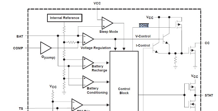

Hi TI expert,
Could you please analysis the details of two issue points in the device diagram:
1. How does the DONE signal (low effective) stop the charge process?
2. How can output CC pin with a P-channel MOSFET turn on and regulate the current?
Thanks.
B R,
Jayce L
  • Hi Jayce,
    When the /DONE signal is pulled low, it drives the gat eof a P-Type FET. That FET is now closed and allows for VCC to flow to the CC MOSFET. The MOSFET is the analog path that controls conduction at the CC pin . The current into the CC pin will control the external BJT or MOSFET.
    The CC is operating as a current source to control the external BJT/MOSFET.
    Please note that this is a functional representation and may not be the exact representation of the internal circuit. Please let me know if there are any application problems.
