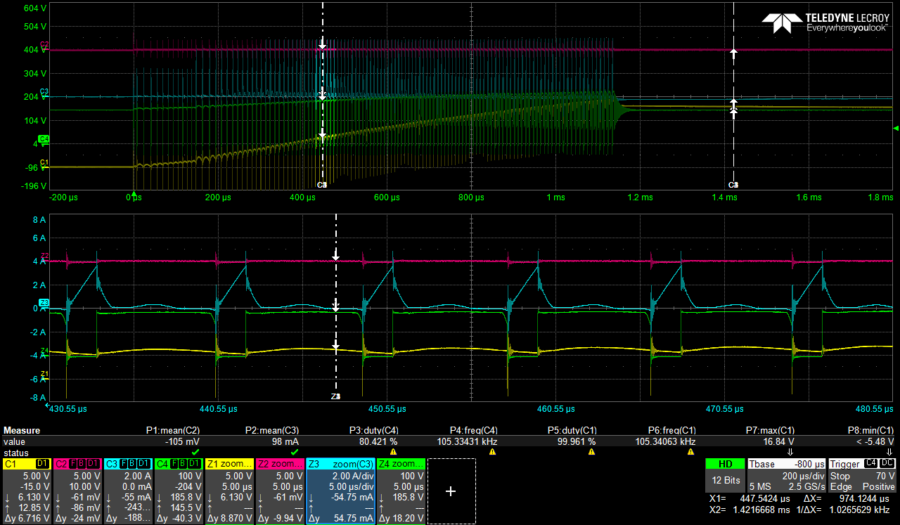

I am experimenting some start-up issue. The converter won't start if a small load is connected on the output and also some times 2 start-up sequence are required to get the rated output voltage.
I have captured the startup waveforms below :
  • CH1 : Voltage at Co1 (secondary resonance)
  • CH2 : Not used
  • CH3 : Current in primary of transformer
  • CH4 :Voltage at switching node (primary)
The target output voltage is 20V and the start-up is aborted at less than 13V.
Once started, the converter behaves almost well (still having some issue between transition from ABM to AAM) and regulation is fine at full power.
