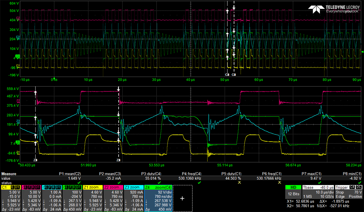

Close to transition from ABM to AAM, the time between each burst is not constant, leading to a "virtual" miss of gating the high side transistor. See picture below:
  • CH1 : Vgs of SR mosfet
  • CH2 : Vgs of high-side mosfet
  • CH3 : Current in primary of transformer
  • CH4 : Voltage at switching node (primary)

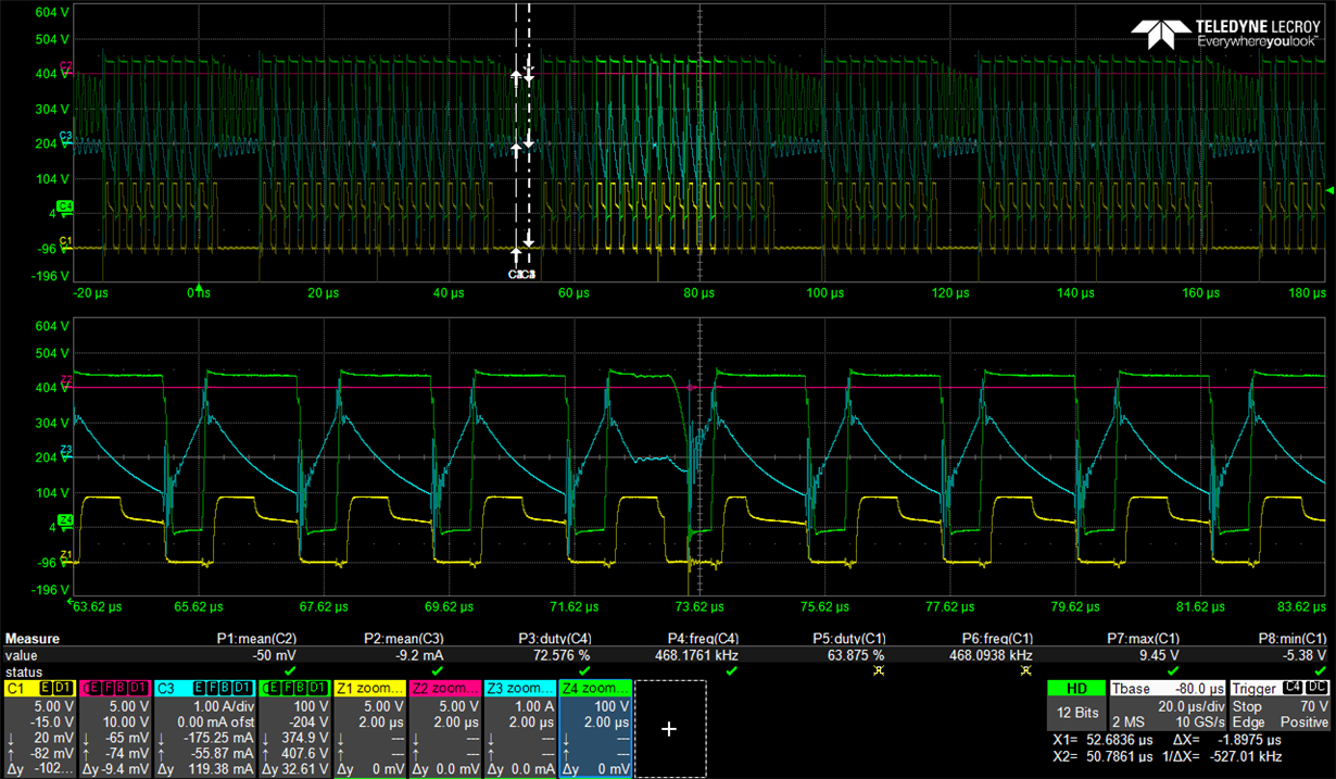

Here is another one at higher load closer to AAM:
(CH2 is not connected that time)
Maybe transitioning sooner to AAM can solve the issue?
