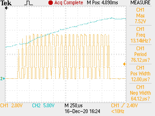

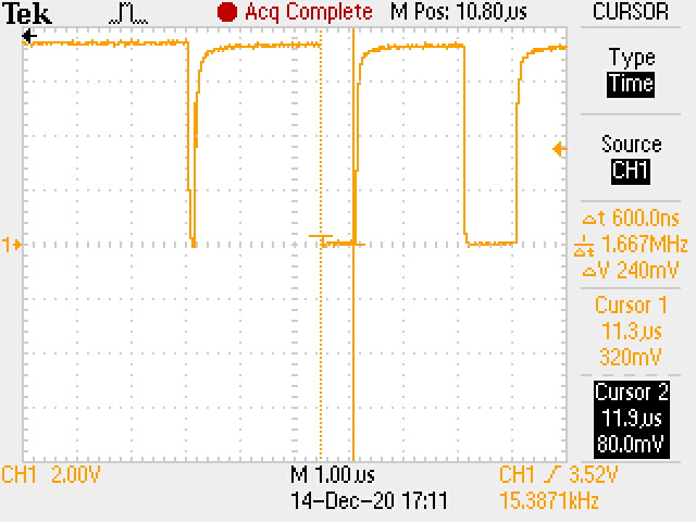

  • Yinsong,

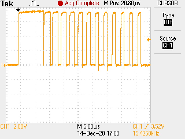

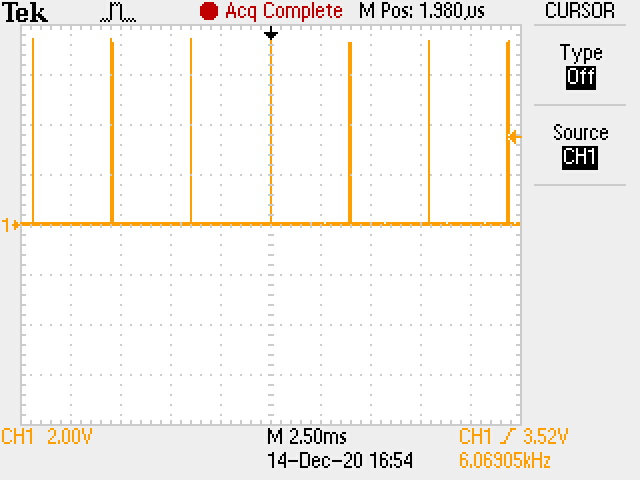

    Today I am observing the system starting up and immediately going into CCM with no evidence of pulse skipping. I varied the input voltage from 10V to 14V to see if the start-up changed but the boost converter started each time with no pulse skipping. The load is about 100mA after the pwoer amplifier completes soft start.
    To attempt to capture the problem I reduced the load at start-up to about 74mA. Now the converter starts up and is in DCM, pulse skipping. I incrementally increased the load as it was running from 74mA to150mA. The converter stayed in DCM during that time as the load increased. When I increased the load to about 158mA the converter switched to CCM.
    I have attached some scope pictures. There are 4 picture while the converter is in DCM, the first is a zoomed out shot, then 3 pictures zoomed in. All are with a 140mA load.
    The converter finally went into CCM when the load increased to 158mA
    Jim
  • Hi Jim,
    Thank you for the waveforms. Do you have the CCM waveform of 158mA load as well?
    Yinsong

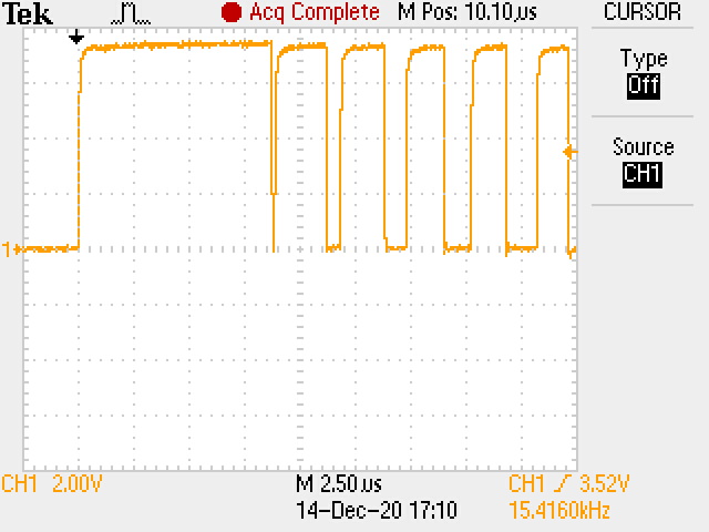

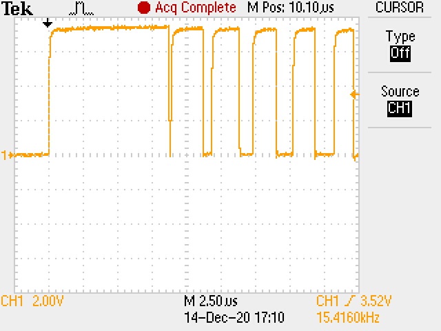

  • Yinsong,
    Here are two waveforms when the converter is in CCM. BTW - these are the gate driver waveforms. The first is zoomed out the second one is zoomed in.
    Jim

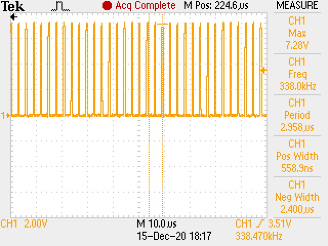

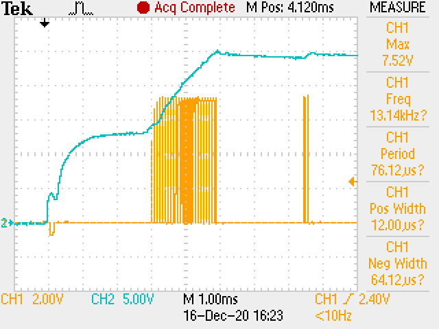

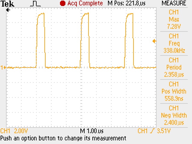

  • Yinsong,
    I have noticed a dependency on the temperature as well. I soldered near the LM3478 and afterwards the converter almost always started in DCM. If I cooled the area the converter was more likely to start in CCM.
    Here are some scope shots of the start-up that resulting in DCM. This is with the system in its "as designed" configuration where the initial load is about 50mA and then 100mA after the power amplifier comes out of soft start. Channel 1 is the gate drive and channel 2 is the 24V output.
    Thanks, Jim
  • Hi Jim,
    It looks like the 558.9ns pulse width is within the 600ns spec. I guess the mismatch just come from the calculation error from the equation, including the component tolerance, etc. In this case, I think you will just need to see if the 200mA dummy load is acceptable to you or not.
    Yinsong
