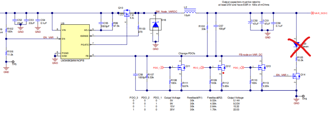

Hi Team,
The customer reports that the vout ripple is large with no load. Their schematic is as same as TPS65987DDJ EVM, including the surrounding component. The only different is that there is no LED on the customer system board.
https://www.ti.com/lit/ug/slvubo9a/slvubo9a.pdf?ts=1608032532260&ref_url=https%253A%252F%252Fwww.ti.com%252Ftool%252FTPS65987EVM

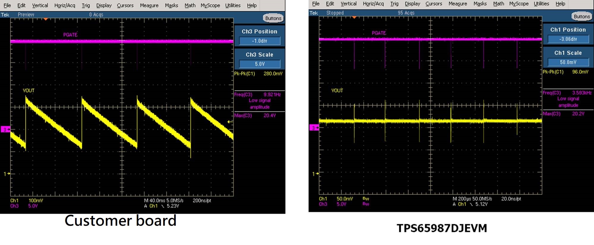

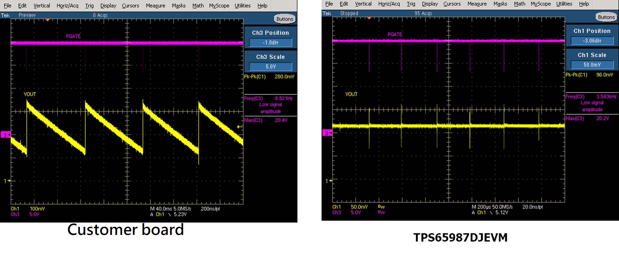

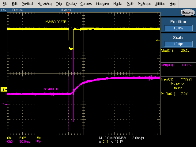

Below is the output ripple comparison between the customer board and EVM. The ripple on the EVM is much smaller than the customer, which might because of there is 0.5mA of load on the EVM(LED).
Zoom in the waveform on the customer, the Pgate turns off once the FB pin reach 10mV.
However, the FB pin is still increasing. Is that because the inductor charging the output cap?
Please kindly provide the suggestion to decrease the output ripple. Thank you.
Mike

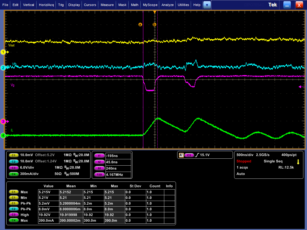

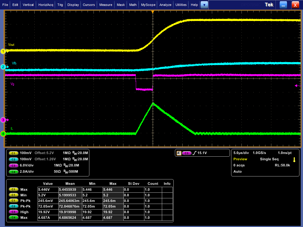

    Thanks for your reply, I had done another test on the customer board.
    The reason of high output ripple might be the rising time of Vfb too slow. The PMOS turns on about 2.95us, then IL rise up to 4.8A.
    Even the PMOS turns off, Vout keeps rising, because the output caps are charged by the inductor.
    Once I remove the 1nF cap between FB pin and Gnd, the rising time of Vfb increase and the Vg turn on time decrease.
    Also, the vout ripple drop to 5.2mV. Please reference the waveform below.

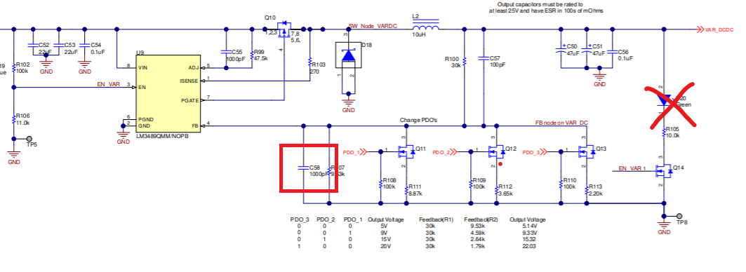

    As I know, C58 cap is used for filter noise on the Vfb. Is there any concern to remove the cap between FB pin and gnd?
    Or what is the minimum value of this cap? Thank you.
    Mike
  • Hi Orlando,
    I also found out that there is no capacitor between FB pin and gnd. It seems that we didn't need that capacitor, right?
    Mike
  • Mike,
    FB capacitance will slow down response of FB node, we usually do not place capacitors on FB node for LM3489.
    Looks like the TPS65987 team placed it there to smoothen the transition between output voltages set by different MOSFETs.
    As long as your output voltage transitions are good then you do not need the FB capacitor.
    If you have overshoot / current limit issues when switching VOUT then you should use a FB capacitor. Try a smaller value capacitor like 22-100pF.
