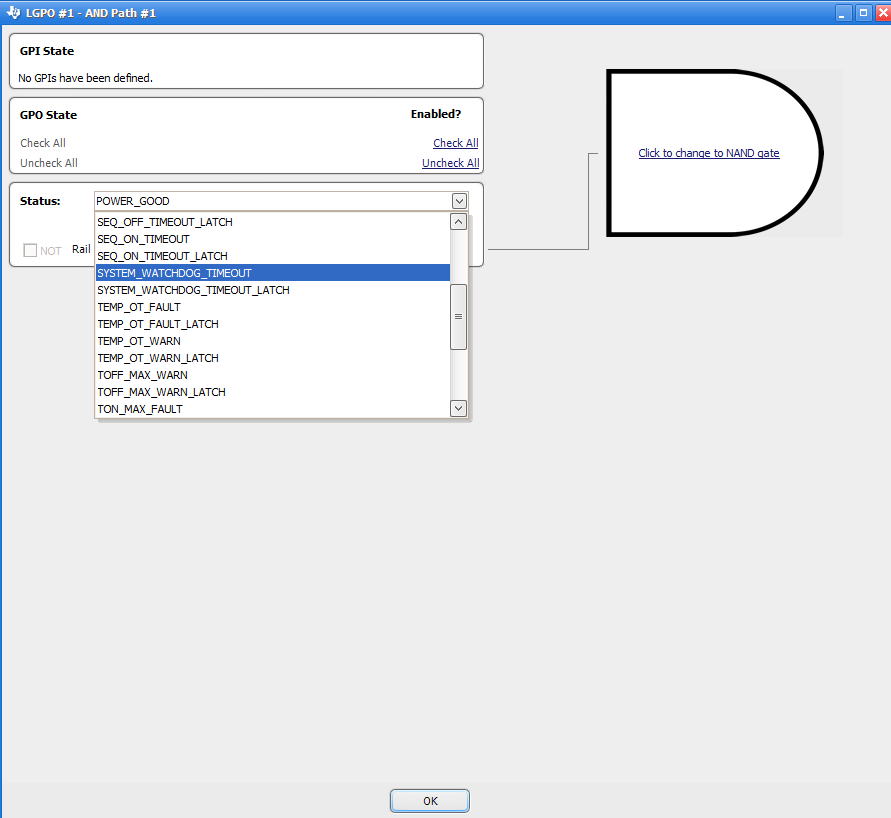

UCD90160A is used on our production, we haven’t enabled Watchdog Timer(WDT) of the part, right now we’d like to enable the WDT without hardware changes( the card has been released to production).
Our expectation is:
                1. After enable the WDT, we like to map the WDO (Watchdog output) to PMON_PORST_N_PT, see the schematics below and Fusion Digital Power Designer configuration below, PMON_PORST_N_PT is already used as card power on reset according POL power good, we’d like add one more control WDO to PMON_PORST_N_PT, but I can’t find out the configuration option from Fusion Digital Power Designer, does UCD90160A support it? and how to configure?
                2. or a power supply re-sequence after watch dog time out, I haven’t found the configuration from Fusion Digital Power Designer, does UCD90160A support it? and how to configure?
See the attached doc for the schematic and UCD90160A configuration.
FrankQuestion about UCD90160A WDT Usage.docx
  • Hello
    #1. yes, you can add the event into the logic GPO. Please refer the below snapshot
    #2. The system watchdog event can not be used for resequencing internally. This signal must be wired back as input to resequencing.
