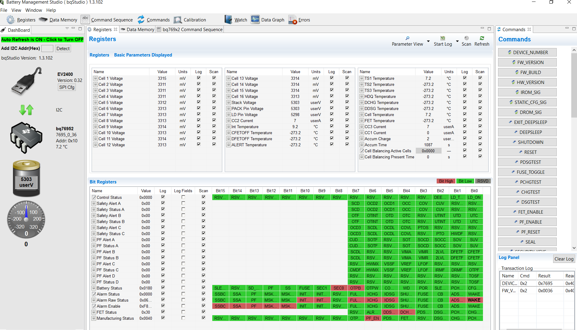

  • Hi, I have my own board, which I have connected to the bqstudio via I2C, and I am currently using BQ Studio to experiment with the settings on my PCB.A screen shot from BQStudio is below, FW Version = 36.
    To try and invoke balancing I am writing 0x0001 into the cell active balancing on this page, by double clicking the value and then pressing enter. Is this not the correct way to load this value?

  • Hi Phil,
    I hadn't tried doing it that way in bqStudio - we don't have many subcommands that can be written with data.  I tried your way and it doesn't seem to be working for me, this may be a bqStudio limitation.  I was using the command sequence tab, to send the subcommand address and data to 0x3e, then the checksum and length to 0x60/61, this way works for me, you might try this approach instead.  Note that to use this you should disable the Auto Refresh (top left of Dashboard page) and disable scanning of the registers (top right of register page), so bqStudio isn't sending transactions between your separate I2C transactions. After sending the sequence, you can manually hit the "refresh" button on the register page to see if the update took.
    Note that you may want to set Settings:Cell Balancing Config:Cell Balance Interval to a long number, such as 255-sec, so it doesn't timeout before you have time to check it.

  • Hi Terry,
    I have run some tests here. I can confirm that sending the balance command using the subcommand write in the command sequence works correctly, and I have successfully run a cell balance.
    In summary - the option to enter a register value on the main screen of BQStudio does not work. You have to enter values using the subcommand sequence.
