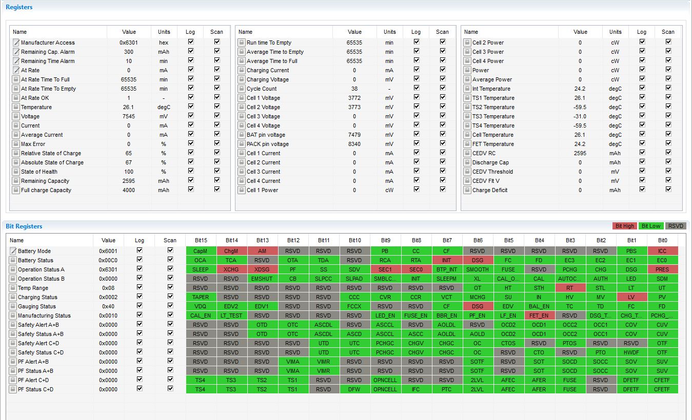

We are using the BQ4050 to protect and gauge a non-removable 2 cell battery pack and are having an issue when this battery pack is completely discharged.  When the BQ4050 turns back on after external power is applied, the FETs do not turn back on even though there are no PF or other protection failures.  I can send the reset command along with the PF_CLEAR, LT_FLUSH, BBR_CLEAR but no commands can turn the CHG and DSG FETs back on.  The only way to turn the FETs on is to set FET_EN to 0 and force them on using the Manufacture Testing commands CHG_FET_TOGGLE and DSG_FET_TOGGLE but doing this disables the firmware in the BQ4050 from controlling the FETs so the protection is disabled.
Why isn't the BQ4050 turning on the FETs when there are no fault conditions?  I cannot cycle power to the BQ4050 because this is an embedded pack and I need to find a way to reset it through commands.
Here are the settings which should have the FETs enabled but they're not:
Is there a command I need to send to tell the BQ4050 that everything is OK and to turn the FETs back on?

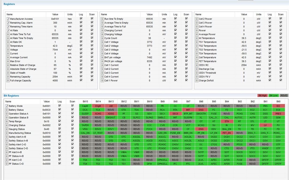

    I have a second unit which was returned by our customer which is showing the same issue.  I grabbed all of the information from this unit which might be better to review since the data wasn't played with before I exported it.  Here is the screen shot of the registers, the .gg and log export while it was plugged into the charger.
    Should I be concerned that the "Discharge Cap", " CEDV Threshold", "CEDV Fit V" and "Charge Deficit" all read 0 on the Register page of bqStudio?
    I have run out of things to try since the gauge isn't giving me any errors but won't turn on the FETs.

    Log of all registers

    The BQ4050 is not going into sleep mode and changing the in-system sleep bit did not allow FET-EN to turn on.
    I've been trying to replicate the issue using the BQ4050EVM without success.  When I load the exact configuration including the calibration values into the EVM, all of the FETs turn on when FET_EN is set high.  I can also replace the BQ4050 in our product, program it and everything works fine.  We are having failures in the field with sold products where the BQ4050 gets into this mode and won't turn on the FETs even though there are no reported issues.
    Are there any other commands I can send the BQ4050 that will reset everything?  It's strange that I can reprogram all of the settings as we do at the factory but there is some persistent information which is preventing the IC from turning on the FETs.
    Can I try to reprogram the firmware in the BQ4050?  I see the firmware version is 0x0001 but don't see any newer firmware on TI's website.
    Is there any information I can provide which will help figure out what's going on?
    Cliff
