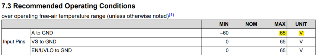

    What is the Max voltage (in all conditions including conditions like load dump) that we can expect on 48V rail in your system ?
    LM7480-Q1 can be used if the Max Operating voltage is less than 65V (Recommended Operating Voltage).
    The HGATE and DGATE and are generated internally w.r.t OUT and A respectively. Their voltages shouldn't be a problem as long as the voltage n A, VS are within the Recommended Operating Conditions.

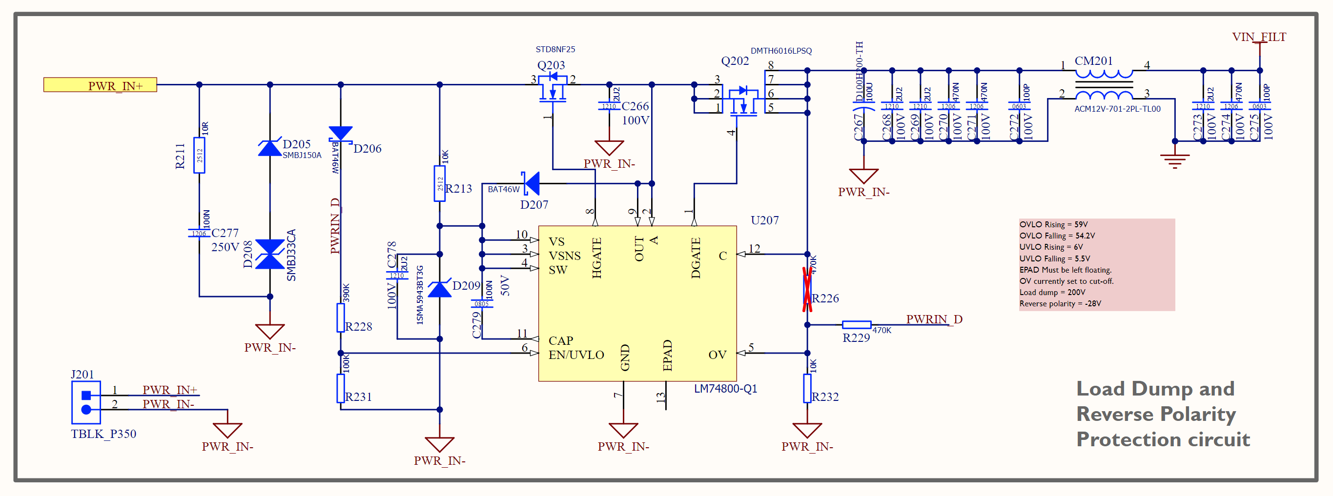

    I am working on the schematic for this, which I will post in the next post, would you be able to review it for me? Thanks in advance
    Navin

  • Hi Praveen
    Thanks for the confirmation, D2 makes sense now. Please find schematic attached, could you please review for me?
    Thank you very much in advance
  • Hi Navin,
    Thanks for sharing the schematics. I will review and get back to you by coming Tuesday.
  • Hi Navin,
    The LM74800-Q1 schematics look good to me.

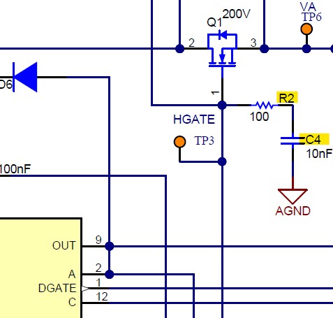

    You can add a R and C in series from HGATE to GND (as shown below) and keep them at DNP. The RC may be useful in case you would like to have a dv/dt start up sometime later.

    Regarding the soft-start, please confirm if R2 needs to be 0603 and C4 needs to be 100V rated?
    Navin
  • Hi Navin,
    R2 can be 0603 or 0402. There will be power dissipation across it only during startup and turn off.
    C4 needs to be rated for > [Vin(max) + 15V]
