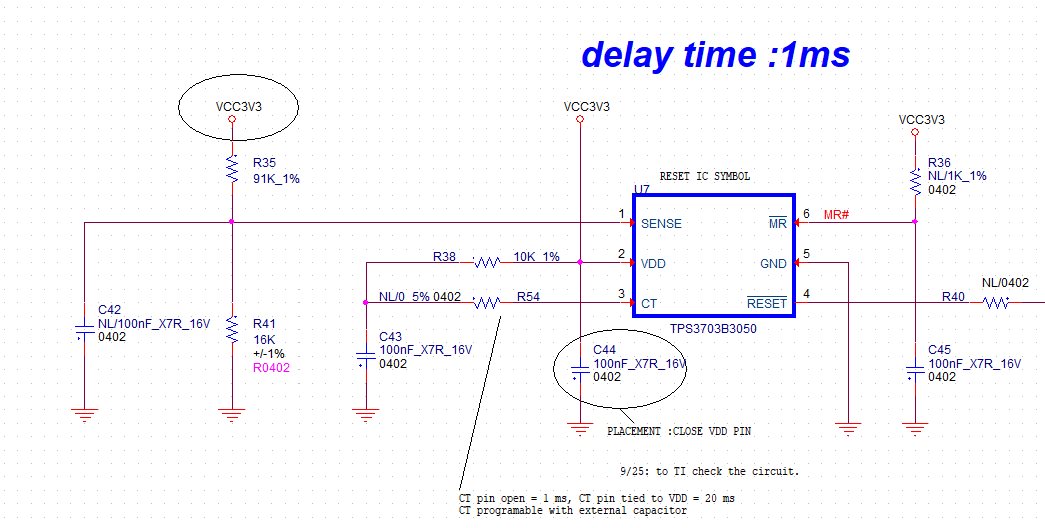

Hi
The pin4 always 70mV so far even if we use pure P3V3 input.
Please check the circuit for the component value setting.
Thank you.
PS: NL means no load.
