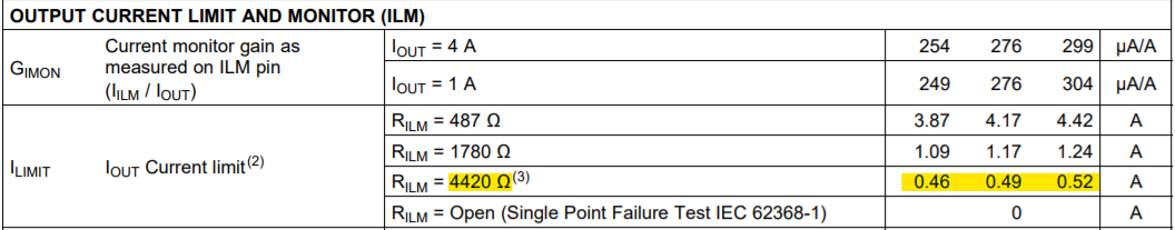

Hello Team,
according to data sheet page 7 a max Rilm of 5kOhm is allowed. If I use the formula (4) on page 21 with 5000Ohm I get a current limit of 0.44A which is below the specified 0.5A on the first page.
Question: is the formula Rilm =  2000 / (Ilimit - 0.04) valid for Rilm = 5kOhm?
Thanks and Best Regards,
Hans

    I would recommend you to not use the device with RILM > 4420 ohms. As you can see in the Electrical Characteristics Table, the device has been characterized with RILM= 4420 ohms.
    You can expect a current limit between 0.46A and 0.52A with a typical value at 0.49A for a RILM setting of 4420 ohms.

  • Hi Praveen,
    if the max value of Rilm = 4420Ohm why do we specify a max value of 5000Ohm?
    What happens when using an Rilm of 5k?

    For a current limit setting of Rilm = 5 kohms, the current limit circuit will work but the accuracy of the current limit circuit is not characterized and hence  unknown. So, it is recommended to not set a current limit value less than 0.49 A (typ).

    can you confirm that the  formula Rilm =  2000 / (Ilimit - 0.04) on page 21 data sheet is only valid up to Rilm = 4420Ohm, please?
    Hans
  • Hi Hans,
    The current limit formula is valid upto Rilm = 5000 Ohm but as I said the accuracy of current limit setting is known only known till Rilm = 4420 ohms
