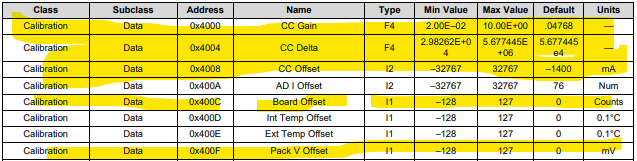

My issue was the BQ35100 : "on some boards the "AccumulatedCapacity" counter is increase from 0 to 4,29E9 and some times on others/sames boards it's decrease (start at 0 and roll over to 4,29E9) 4,29E9 to 0. (Same hardware, not able to charge the cells)."
And it's still the same.. but i have more informations.

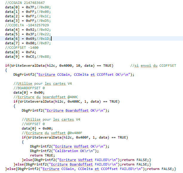

I have manually change the calibration data (CCoffset, DeltaOffset, CCGain, Voffset, BoardOffset) by doing means of them etc.. I did this to get close of the real consumption i had.

    I would recommend getting the EV2400 to speed up testing and debug, you can also use the calibration method provided in bqStudio to see if it will yield different gains.
    The .gg file will contain all the values you have configured on the gauge including calibration information, so it's fastest to use that file format because I can directly import it on my side.
    I'm not sure I understand what you mean, how are you manually changing the calibration?

  • Hello Wyatt,
    - Ok i see but i don't have this tool.. i will ask my boss for it
    I'm not sure I understand what you mean, how are you manually changing the calibration ?
    - I'm changing this data, I did average for this data on 10 boards then I had fix this data to have less difference between the accumulated capacity return by the BQ35100 and my calcul (first message). (I saw that is a good way to do there : "https ://e2e.ti.com/support/power-management/f/196/p/949789/3509533?tisearch=e2e-sitesearch&keymatch=BQ35100%2520accumulated#3509533" btw that was you ! :) )

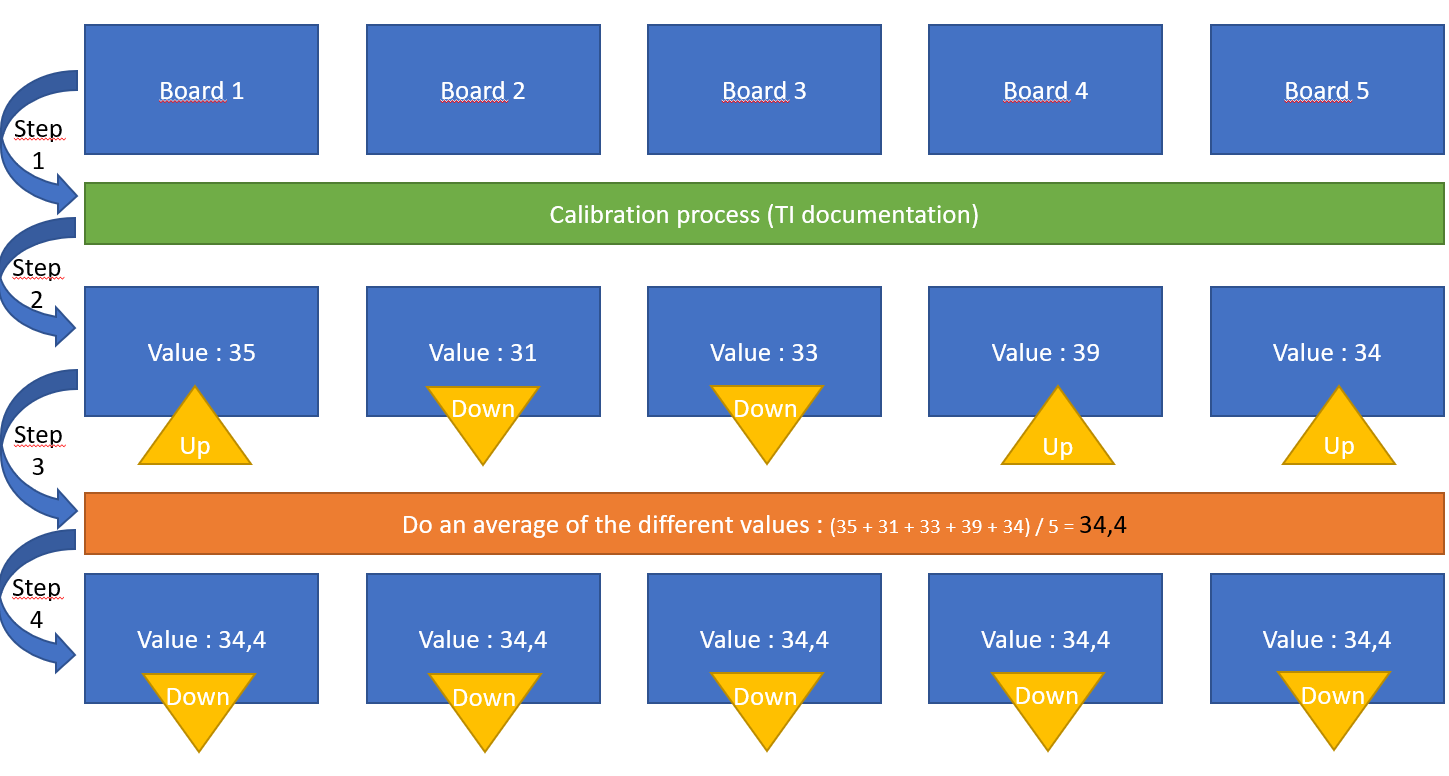

    I will try to explain my issue in a different way.
    So, for example (values are not the BQ values but it's the same idea, right ?)
    Step 1 : I take 5 boards (same boards)
    Step 2 : I do the calibration process of TI on 5 boards. Same conditions (battery even, board even, way of current even, consumption even)
    Step 3 : After verification all the value are good and the accumulated capacity counter of each BQ are near from the real current consumption during 5sec. (first message of the thread)
    Some of them are "counting up" and the other are "counting down" but the accumulated capacity are good in both case. WHY some times counting UP and some times DOWN ???
    Step 4 : Make an average of the diffrent values to put it on each BQ for the production phase at the factory. Then they are all counting in the same way (here down).
    Can you tell me why this is happening ?

  • Hello Goulwen,
    I was able to re-create which way the gauge counts by changing the CC offset, I'm guessing this could be your issue. Can you export the .gg file when you get the EV2400 so I can take a look at the configuration? Maybe there is an issue when you write these calibration values, but it can cause this to happen.

  • Hello Wyatt,
    - Yes that could be the issue i'm facing.. Do you have an explanation about it ?
    - Sorry but we don't have this tool i guess we won't have it one day..
    - I think all my values are nicely write because i'm doing a read verification after..

  • Hello Goulwen,
    If your CC offset is written incorrectly it could flip between the two depending on your load current.
    We will need the EV2400 and bqStudio to do further debug because it's not clear if the values are being written correctly.
