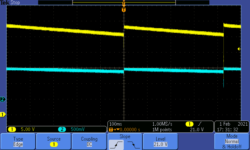

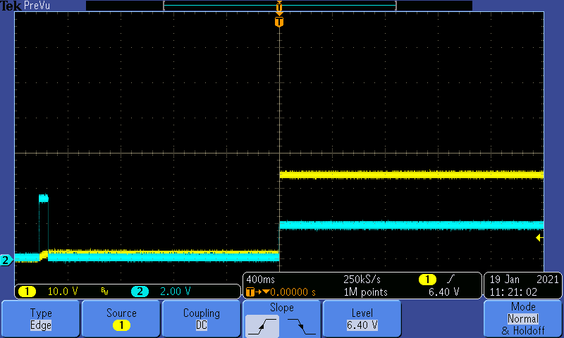

WORKING: Here is what the output voltage (yellow trace) looks like when the unit is powered-up from 18V.  The blue trace is the COMP pin.

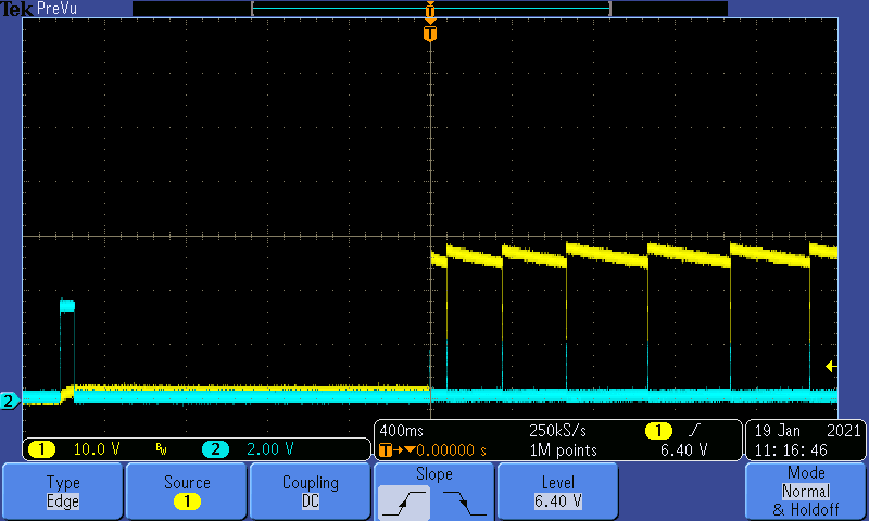

NON-WORKING: Here is what the output voltage (yellow trace) looks like when the unit is powered up from 21V.  The blue trace is the COMP pin.
Can anyone tell me what is going on???  I've verified all my component values, and I've tried various different values for compensation and soft-start.

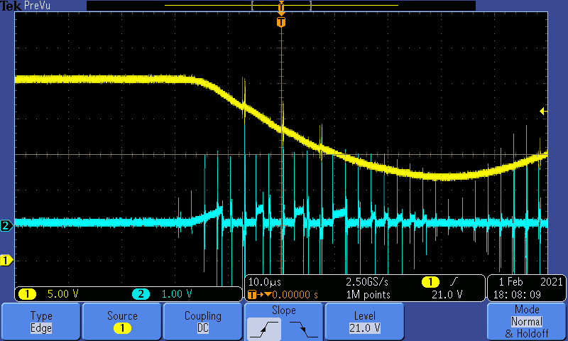

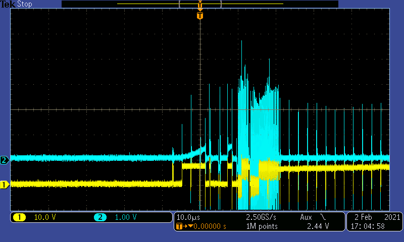

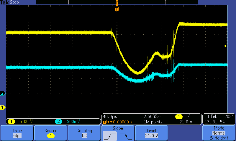

    By way of review, here is a scope shot of the output waveform (yellow) and the FB waveform (blue):
    Here is an expansion of the trigger point:
    Since there is no load, where is all the energy going when the output plunges to half its value?  There is ~130uF on this output line.  Is it possible that Q39 and Q40 are on simultaneously?

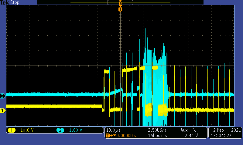

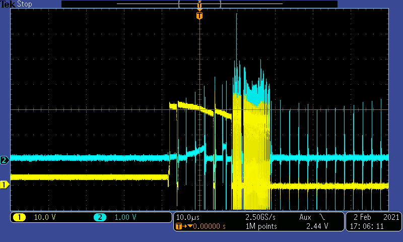

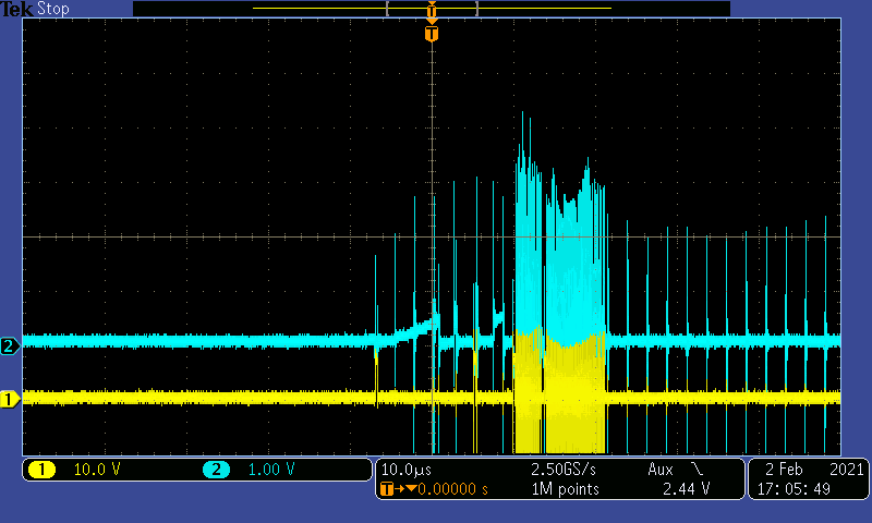

  • In an effort to track down where the energy goes, I took shots that compared the drop across the sense resistor (blue) with the gate signals from each of the switcher MOSFETs (yellow). Since I only have a 2-channel oscilloscope, these are taken in four different shots. Nonetheless, the relationship between the heavy current pulses and the FET gate signals is clear.
    Yellow = gate of Q37
    Yellow = gate of Q38
    Yellow = gate of Q39
    Yellow = gate of Q40
     The input voltage is set to 19V and it is being boosted to 24V. Under normal operation, Q37 & Q40 should conduct during the first part of the cycle to allow current to build up in the inductor. During the second part of the cycle, Q38 & Q39 should conduct to allow current to flow from ground to the output.
     The pictures appear to show the second half of the cycle where Q38 & Q39 are simultaneously conducting, but the current is flowing backward from the output filter capacitors to ground. Note how the current is ramping upward from zero. (The inductor is 3.3uH, and RDSon of the MOSFETs is 4.2mΩ. The sense resistor is 7mΩ. Thus, the time constant should be about 200uS.)
    Why is the regulator is turning on Q38 & Q39 at a point where the current is already zero?  Shouldn't the soft-start (or some other feature) prevent this?

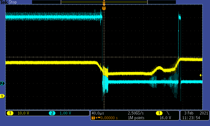

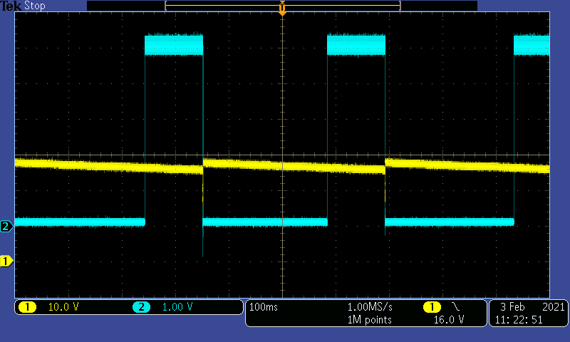

    Here is the PGOOD signal (blue) along with the output voltage (yellow):
    Here is the same shot showing the detail of the falling edge:
    If I reduce the supply voltage below 17V, the circuit works properly.  Likewise, it works properly if I increase the supply voltage above 31V.
