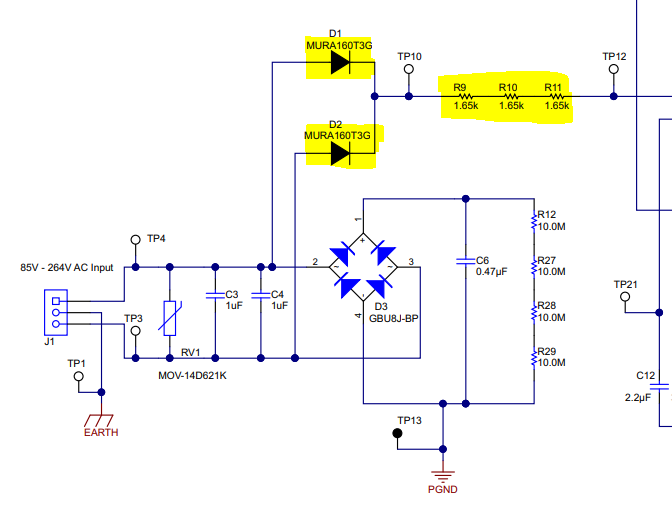

My Customer is looking at the UCC25630-1EVM-291 schematic and wanted to know
why the HV pin1 is connected to rectified ac input via a resistor string.
Checking further the UCC256303  datasheet states the HV pin must be connected to GND.
