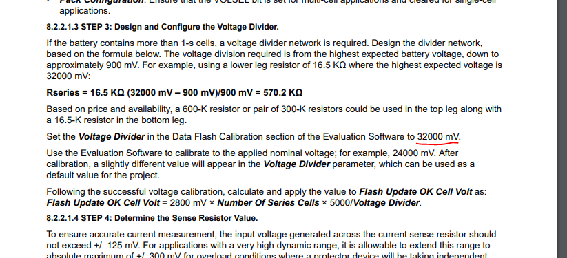

    I was tried to recalibrate the voltage and then something went wrong after that, the current always stays at -32767 mA even there is no load connected. And I cannot reprogram the chip with a golden image file, but no problem to read from/ write to the registers. The steps I did to calibrate the voltage is: 1. Write 32000 in the voltage divider 2. Measure the voltage between BAT+ and BAT- 3. Go to voltage calibration and write the voltage under applied voltage. Anything wrong with my steps?
    Then I replaced the BQ34Z100 chip, I found another abnormal phenomenon on EVM board, the LED0 - LED9 were flashing once a while, maybe every half minute. Even sometimes they all went off, only the LED0 lights up. If I connected the charger, they blink every second. There is no problem to read/write or load the golden image file, and everything else seems normal. What could be wrong on the board? Have you seen this before?
    Thanks.
    Charles

  • Hi Wyatt,
    I was following the steps on page 50 of BQ34Z100-G1 datasheet. The voltage divider updates to around 37000 mV after I input the actual voltage value in the voltage calibration box, which seems correct.
    I think the LEDs flashing is due to voltage drop on REGIN from time to time. I am not quite sure what causes that, but I will replace two shift registers SN74HC164PW to see if they are pulling down the voltage to ground level once a while.
  • Hello Charles,
    You should use the guide in the datasheet to setup the DF values, then use the EVM guide to calibrate the voltage.
    There may be some issue with your setup if they are flashing, there are no settings to cause the LEDs to flash for this gauge.
    Sincerely,
    Wyatt Keller
