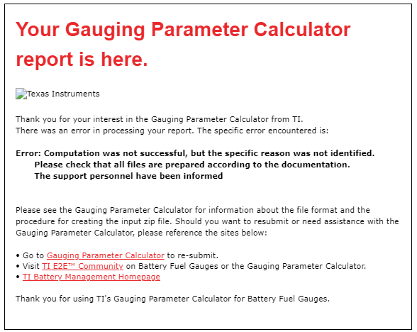

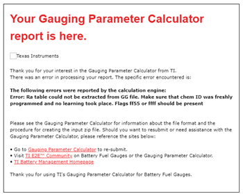

I need help. I did tests but after upload, I got failed results.
GPCRA0 - failed (check screenshot) and zip file with raw data  GRCRA0_2.zip
GPCRB - failed (check screenshot) and zip file with raw data GPCRB_3.zip
And also BQ2741-G1B doesn't have this flag "Flags ff55 or ffff should be present"
What did I wrong?

  • Hello Michael,
    This gauge is a ROM gauge and does not have flash memory, for optimization in lower temperatures it would probably be best to use a flash gauge so you can edit these parameters.

  • Hello Wyatt Keller,
    I’m aware that BQ27421-G1B does not have FLASH memory. The fuel gauge is always connected to the battery(whole device lifetime), and all the configuration data is stored in the ROM of the IC, unless the battery gets disconnected by the protection circuitry for some reason. If reset is detected - the host device provides configuration data to the IC immediately.
    The main problem is - when the device is exposed to low temperatures(anything below 0°С - -5°С) the fuel gauge starts to show percentage drop/swing after some time (check the logs in my previous post: https://e2e.ti.com/support/power-management/f/196/t/973208). Usually the workflow is like this: when some significant amount of current is drained from the battery(around 0,2-0,3 Amperes) for 10 seconds usually, and up to 60 seconds, there is a voltage drop(up to 0,5 Volts). As a result the battery voltage recovers to the previous magnitude, but the percentage value on the fuel gauge IC is kept near the lowest reading.
    For example: the environment temperature is -5°С, the battery is at 50% (3,8 Volts), then for 30 seconds 0,25 Amperes is drained by the system, and the voltage drops from 3,8 Volts to 3,3 Volts. Also the battery percentage on the fuel gauge IC descends to 0%. After some time the initial battery voltage is slowly restored to a close value before the load event, but the percentage stays at 0% forever, unless you start charging the device.
    I had already executed these tests, recommended in my previous topic:
    https://www.ti.com/tool/GPCRB
    https://www.ti.com/tool/GPCRA0
    But unfortunately after uploading the test results I always get error reports… (see test results screenshots above in the beginning of this topic)
    What am I doing wrong?
    I need to know how to configure the fuel gauge in order to work correctly at low temperatures. What parameters like Qmax, Ra, and Thermal coefficients should I change from the default values?

  • Hello Michael,
    Do you use the smoothing function for the gauge? Depending on the configuration SOC may not change from 0% when the temperature has changed while the gauge was in relax mode.
    The ROM based gauges are not compatible with the GPCRB tool directly. I would recommend using a flash based gauge to allow these parameters to be easily adjusted. At cold temperatures sometimes an Rb tweak is necessary for accurate gauging.

  • Hi Michael,
    GPCRB and GPCRA0 are failing because it is a ROM gauge. There is a workaround but you would have to upload the gm.fs file everytime the gauge losses power.

  • Hi Michael,
    I have sent you a friend request we can discuss offline, can you also  provide a .gg after a learning cycle has been performed? The one you provided only contains the default values and it needs to match your battery.
