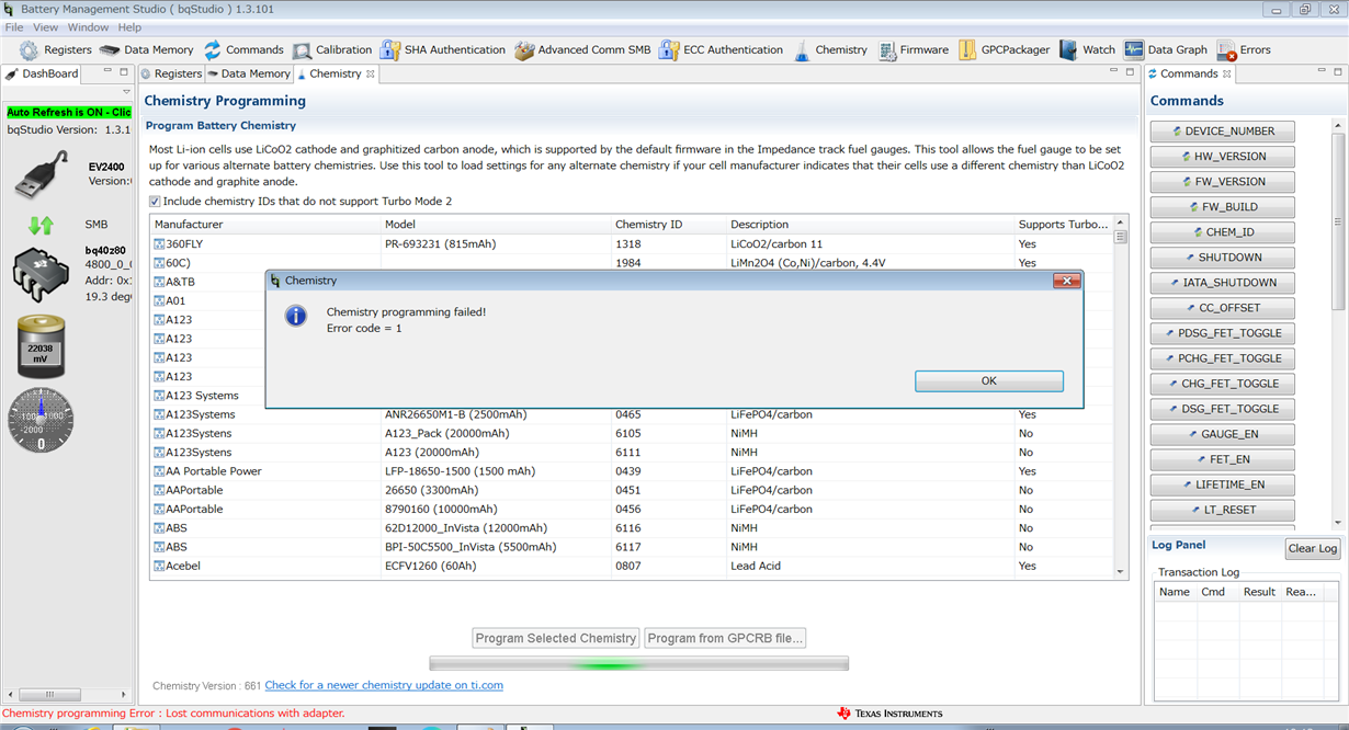

I've faced the issue that Chemistry programming failed(Error code=1) has occurred when writing chemdat12_ID**** from GPCRB tool.
I reinstalled the latest version of bqStudio the other day to avoid crashing when I program chemdat12_ID**** through EV2400
I also updated the firmware since I was not able to select the device I used before.
Would you help me out of this situation?

  • Hello Kunny,
    Are you able to program other chemistry IDs without the error, is it only for the chemistry you had characterized you get the error?
    Sincerely,
    Wyatt Keller
  • Hi, Wyatt
    I can write the original chemID provided from bqStudio with no error as I used to.
    I think the chemdat12_ID**** from GPCRB tool only cause this issue so far.

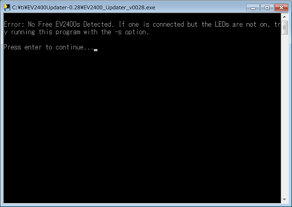

  • Hi Shirish,
    I tried to upgrade the firmware of EV2400 from 0.18 to 0.28, it has failed.
    I got the error message as attached below.
    With -s option, it went wrong, as well.
    The bqStudio can communicate with the device of BQ40Z80 through EV2400 connected to PC via USB.
    What should I do?
    I'm concerned about the message "No Free EV2400s Detected."  Do I try to use the different or wrong firmware updater?
    Kunny
  • Hi Shirish,
    I've found out the reason I couldn't update the firmware.
    The bqStudio remained simply running during update.
    After terminating the bqStudio's communication, it has successfully finished(version 0.28).

  • Hello Kunny,
    The error description shows that bqStudio lost communication with the EV2400. You can push the reset button on EV2400 and try. This button is equivalent to a power cycle of EV2400.
    Alternatively, try turning off dashboard Auto refresh. I will check with the team if there can be other causes.

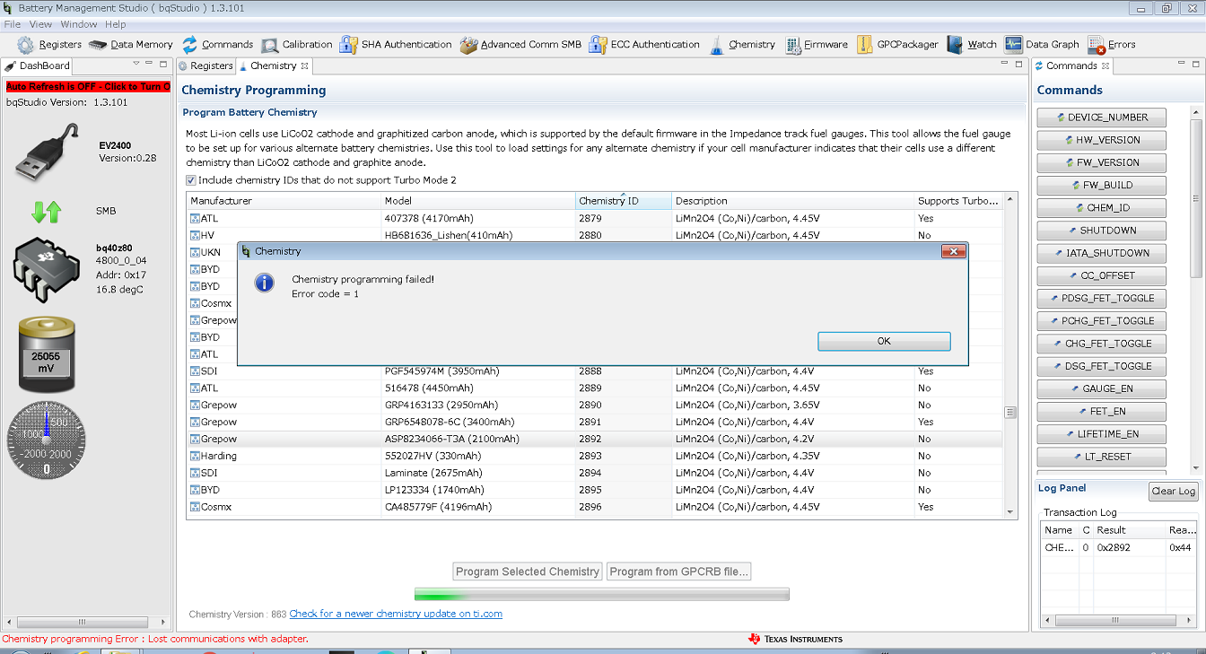

  • Hi Kunny,
    I notice in your screenshot that you are using an old verison of chemistry. There was  a change in chemistry ID assignment and that could be the cause.
    Please update your chemistry from
    In case you have not done this before, then instructions are provided in the link.
    Let me know if that helps.
  • Hi Shirish,
    I updated the chemID(latest version 863), nothing has changed, though.
    I have a question regarding a change in chemID assignment.
    I've used the best matched chemID of 2892 for my battery,
    Does this mean the number of "2892" has changed?
    Do I have to get the newest chemID again for my battery, then take the other steps like learning cycle and GPCRB?
    Kunny
  • I am not seeing chem ID 2892. Try to resubmit the files to GPC and get an updated ChemID match, then resubmit with new ChemiID to get the GPCRb file.

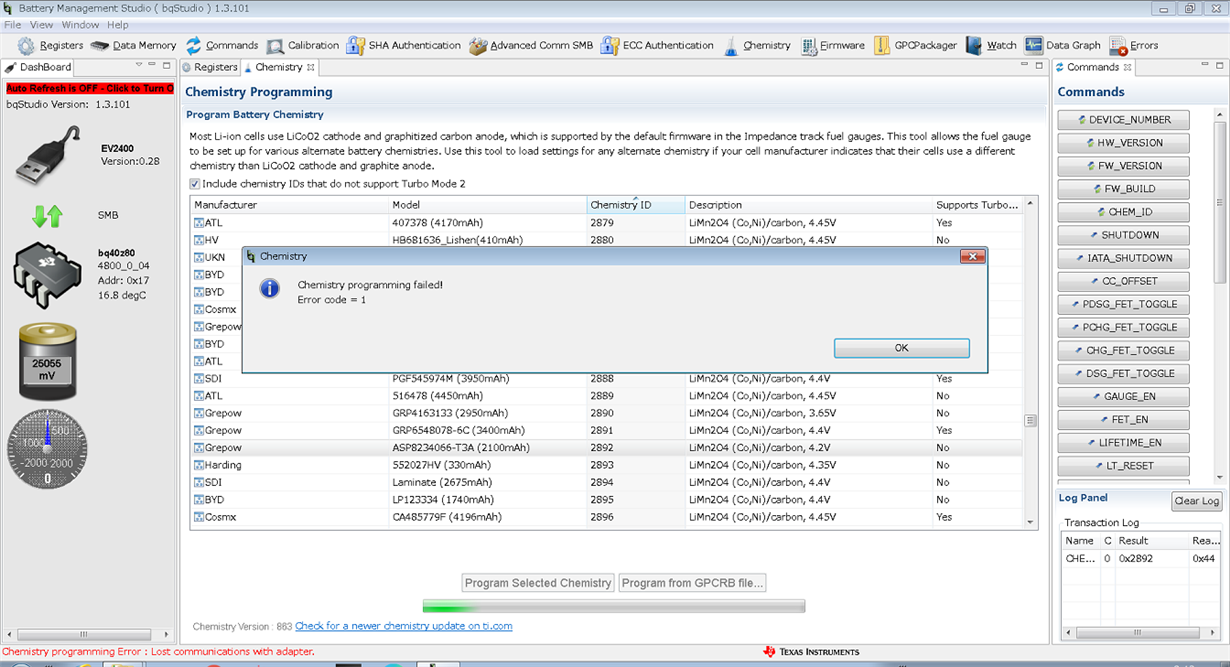

  • My chemID getting from learning cycle does not support Turbo Mode 2.
    So, we are not seeing chemID 2892 unless checking "Include chemistry IDs that do not support Turbo Mode 2" on bqStudio.
    Doesn't the chemID without Turbo Mode 2 support  accept GPCRB data to add?
    Regard,
    Kunny
  • Hello Kunny,
    Thanks for the clarification. GPCRB progamming is expected to work for chemistries that do not support Turbo mode 2.
    Have you tried resubmitting to get the file again just in case the file is corrupted(unlikely but lets positively rule it out)
