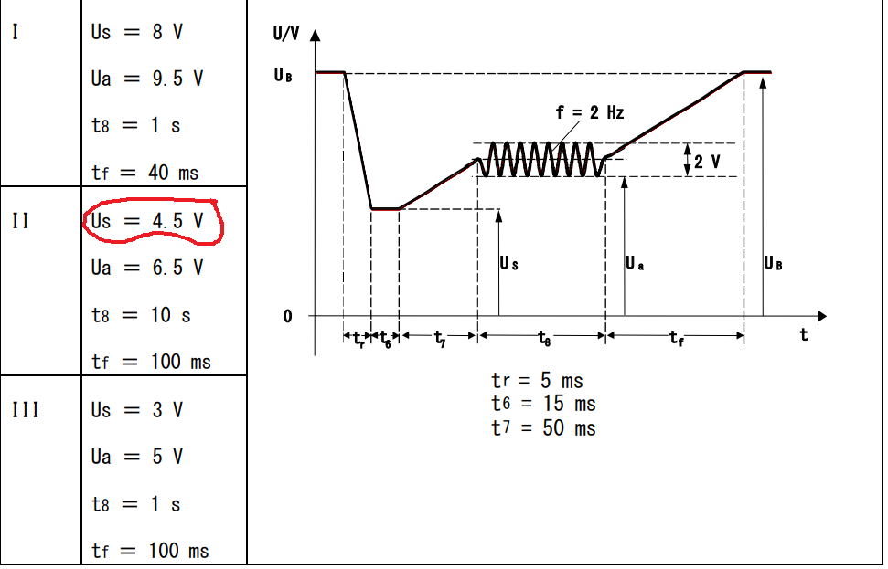

We have a trouble about reverse current detection when we check ISO16750 , the waveform as below:
The IC TPS7B7701 detect the short-to-BAT error now and then.
We add a diode before Vin, It can avoid error detection of the short to battery and reverse current. and this trouble is eliminated.

    1. For STB, the circuit for the detection is similar to a comparator circuit that is comparing Vin and Vout during the startup. For RC, it will be trigger by high than 1mA(typically 50mA) of current flowing into the output of the LDO, and as you have noticed, the current will need to last around 5uS. The RC is protecting the LDO from damage due to the current flowing through the body diode of the pass-FET and it only becomes necessary when the reverse current reaches a certain value.

    As the output may have long cable connecting to the load, the inductive could excessive voltage spikes that may trigger the RC.
    2. I got the response from the design team, and to clear the error state, the EN needs to stay low for at least 10uS.

  • 1. For STB, the circuit for the detection is similar to a comparator circuit that is comparing Vin and Vout during the startup. For RC, it will be trigger by high than 1mA(typically 50mA) of current flowing into the output of the LDO, and as you have noticed, the current will need to last around 5uS. The RC is protecting the LDO from damage due to the current flowing through the body diode of the pass-FET and it only becomes necessary when the reverse current reaches a certain value.
    -》Is STB  only detect during the at startup?
         we found the error when we check the  waveform of  ISO16750  is RC ,is it right ?
         a diode add before TPS7B7701 is not recommend ,because it may hinder the RC detection ?
  • Is STB  only detect during the at startup?
    Yes, the STB is only checked during startup. If the part is already powered-on, and an RC/STB error shows up, it is RC.
    The RC is designed to help the LDO and having the diode before the input is optional.
