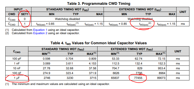

As a result, SET1 is asserted as Low, but /WDO is output as High.

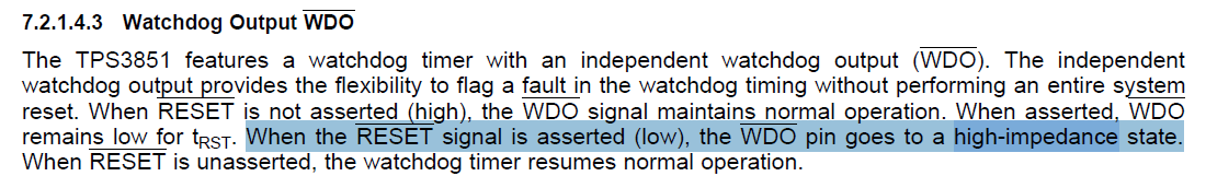

When SET1 is asserted low, the watchdog timer is disabled and /WDO becomes high-Z state.
On the datasheet, isn't /WDO going to high-Z state when a RESET not SET1 is asserted low?
May I ask you about that?
When SET1 is Low, is the part related to /WDO status on the data sheet?
Could it be that SET1 high output for several seconds during initial booting, could be the cause of making /WDO high??
No, /WDO is high because the SET1 pin is pulled low. When SET1 is pulled low, any input to the WDI pin is ignored.
"No, /WDO is high because the SET1 pin is pulled low." <- This is also the case.
Please check, and your answers are helpful to me.
    When SET1 is low, the watchdog function is disabled.  Therefore, the /WDO pin will go to a high-Z state allowing the user to still use the TPS3851 as a supervisor.  Also, /WDO only asserts if the /RESET output is not asserted.  If /RESET is asserted, the /WDO state is high-Z state.
    May I ask you about that? When SET1 is Low, is the part related to /WDO status on the data sheet?
    No, when SET1 is low, the watchdog feature is turned off and /WDO will become high-Z.
    In your application, the schematic shows SET=1 and CWD=1uF.  This means that the initial tWD time is 77.455seconds.  See below:
    In your scope photos, /WDO is high.  This explains why the /WDO stays high in the beginning.  The initial setup for tWD is 77.455secs and then SET1 is pulled low which maintains /WDO to be high.
