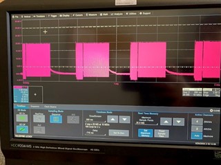

Can you take a scope capture of VCC, SRN, PH and STAT1 when there is no battery connected?
Here are the requested pictures. The order is VCC, SRN, PH, STAT1. The last picture has PH (pink), SRN (blue) and STAT1 (green) in one capture so you can see the related timing.
Hi Katrina,
This behavior doesn't look right. Your VCC has a huge ripple even though there is no load, and it looks like something is limiting your adapter and the PH signal is not as expected, as a result. Do you have a current limit on your input source?
My input power source for this board is 3 AC-DC current sharing power supplies (PN: IRM-90-12). The max current out put of each supply is 6.7A. What makes you think it is current limited? BTW--In order to capture enough information on the oscope i had to sequence the readings--not sure if that contributes to the strangeness you are seeing.

Something is incorrect with this battery absent detection shown in the scope captures. Can you test your input source with an EVM and take a scope capture of the battery absent scheme? I don't see anything incorrect with the schematic. Figure 20 of the datasheet is expected behavior.
