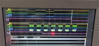

    The MCU tried to contact 79600 by sending two commands to wake up the ping and SPI, but 79600 did not respond.The waveform of the attachment ,The top half is two wake-up pings And an SPI message,The bottom half is to magnify that message。CH4 is SPIRDY。
  • Hi Jiao,
    From the image it appears that nCS is being driven high by the MCU during the command frame at the end of the bytes. From section 7.3.2.1.2.2 SPI of the datasheet:
    Please ensure that nCS is held low for the duration of the command frame and try again.
    Geoff
  • First of all, thank you very much for your reply
    The current phenomenon is that the 79616 device on the Daisy chain has shown a wake-up state,But there was still no data on the SPI's MISO data line,I Want to ask for Under what circumstances or under what command will SPI respond.thank you
  • Hi Jiao,
    The 79616 device will only reply to read commands, not to writes. Before trying to read/write to stack devices please make sure that you follow section 7.3.2.3.1 of the BQ79600 datasheet to auto-address all devices.
    Geoff
