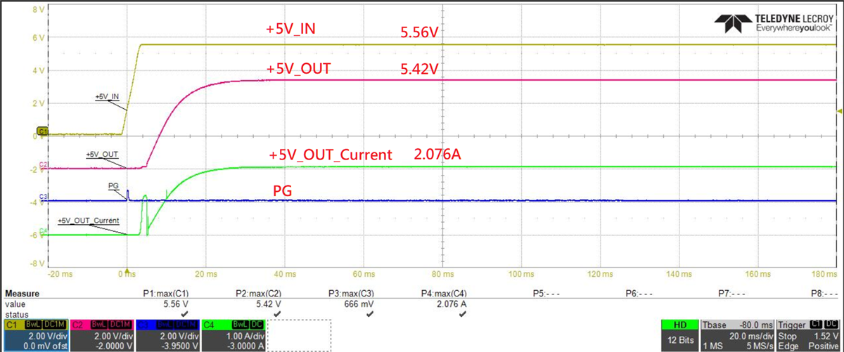

2. Scenario 2, CR is set at 2.067ohm.(the Iout current should be about 2.69A)
After Vout cap. is fully charged, Iout raised and limited at 2.076A and Vout just raised to 5.42V but it still large than PGTH. But why PG pin was still at low level?
When we disabled electronic load, Iout reduced to 0A and PG signal can raise to high level. Enable electronic load again, PG was at high level just for a while meanwhile Iout raised to 2.69A. TPS259474 entered into circuit breaker after ITIMER was expired
The PG behavior here is similar to scenario 1 during soft-start period.

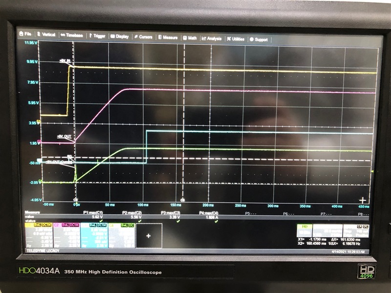

    1. We had tested it. With no load(eload is off) the Vout can be established to close to Vin voltage and PG raised to high level. I didn't capture the waveform but you can refer to below one.
    The eload was set at CR mode and sink current was about 1.806A which is under current limited threshold. PG signal raised to high level normally.

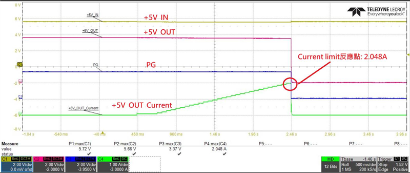

    Please find below waveform, we tried to increase load current step by step, then we can find the threshold of current limit. It is about 2.048A.
    Besides, power on efuse without eload enabled then enable load to sink 1.926A the PG signal still maintain at high level.

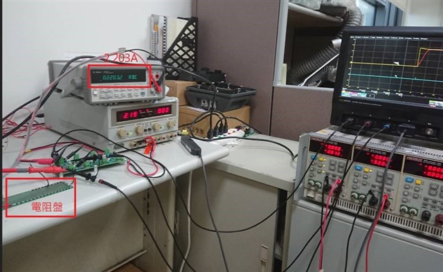

    As to the experiment of changing to pure resistive load, this issue is still there. Please find my explanation below.
    Changing the current limit threshold to 2.304A(measured value).
    1. Set eload to sink 2.195A and enabling eload before turn on TPS259474. PG signal cannot raise to high level after soft-start, sink current keeps at 2.195A. TPS259474 not shutdown.
    2. Change load to a real resistor, the sink current is about 2.203A. the PG signal cannot raise to high level too.
    I think are you be able to setup same environment to replicate this issue? it would be helpful to understand this issue quickly.
