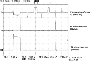

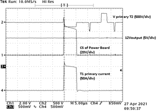

I've been testing the UCC27714EVM-551 board, and under no-load condition I saw on the CS pin of the Power Board (not exactly the CS pin of the UCC28950, as there's a 1k-330pF RC filter between both) peak voltages of around 40-60V.
Seeing the current through the primary of T1 (current-sense transformer), it was confirmed, as there were peak currents of about 100A with a duration of less than 10us.
Apparently, there was little to no effect in the 12V output.
With a minimum load of about 2W this effect this disappears.
1) Why is this happening?
2) How is this not dangerous for the UCC28950 (CS pin) or for the primary mosfets?

    As I said, with the GND of the oscilloscope connected to the control GND (while monitoring the CS signal), these current peaks appeared with no-load at the output.
    Adding also two differential probes between G and S of Q1 and Q3 or Q2 and Q4, these peaks were still high but not so much as only with the probe connected to CS and control GND.
    Disconnecting the ground wire of the probe from control GND, I didn't see the current peaks.
    It appears to be related to noise in the drivers or something like that in these particular conditions, because with a minimum load of 100mA at the output, this problem disappeared. With currents of around 100A with no effect at the output, and seeing that the primary transformer voltage is about half the Vbus during these peaks (see my first post), it could be a shoot-through, some mosfet in the linear region, or something like that.
