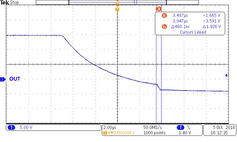

  • Hello Joris,
    Our modeling team is still working on this fix.
    I went ahead and used the UCC5350M with the UCC5320SCDEVM-058 and produced the following waveform to show proof of concept.
    Test conditions:
    VCC2 = 15V
    VEE2 = -5V
    Referenced to GND2 on EVM
    You can see the clamp activating ~2V above VEE2 which is about -3V.
    I'm going to close the thread for now and reopen when the modeling team has completed the spice model fix.
    Mateo
