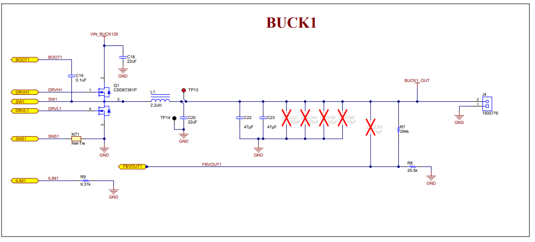

For one of our MPSOC (XCZU6CG) based design we have chosen to use TPS6508641
I have strictly followed the user guide and datasheet of TPS6508641
Posted are the Schematic of TPS6508641, for which the timing diagram is also attached
Power_Sequence_MPSOC_XCZU6CG.pdf
SCHEMATIC_PMIC_MPSOC_XCZU6CG.pdf
Kindly let us know whether the schematic will adhere to the timing sequence or not

  • Hi Shyam Daram,
    I have listed some notes below for you to review.
    1. You must terminate any unused LDOs (in your case LDOA3) with an output capacitor that is connected to ground. If you do not have LDOA3 connected to a capacitor then you will experience a power fault on startup and the device will not complete the sequencing process. We recommend a 4.7uF capacitor for this.
    2. There is a minimum recommendation of 44uF capacitance on the output of BUCK1/2/6, and we typically recommend using around 100uF capacitance. If you chose to use a lower value around 44uF, you may consider adding some un-populated pads near the other output capacitors in case you need to add more later for better performance. Having more capacitance will improve the ripple on the output of these rails.
    3. It seems like you are missing a connector that should be between C277, R205, and R204.
    4. You may already have them on another sheet, but make sure to have pull-ups for the CLK, DATA, and other digital I/O signals you are using.
    Let me know if you have any questions about my comments.
    Layne J

  • 1. As Suggested, shall i replace the 22uF capacitors i have placed at output of 1/2/6 Bucks with a 100uF ? , kindly suggest the type also , shall i go with a Tantalum type or a MLCC ?

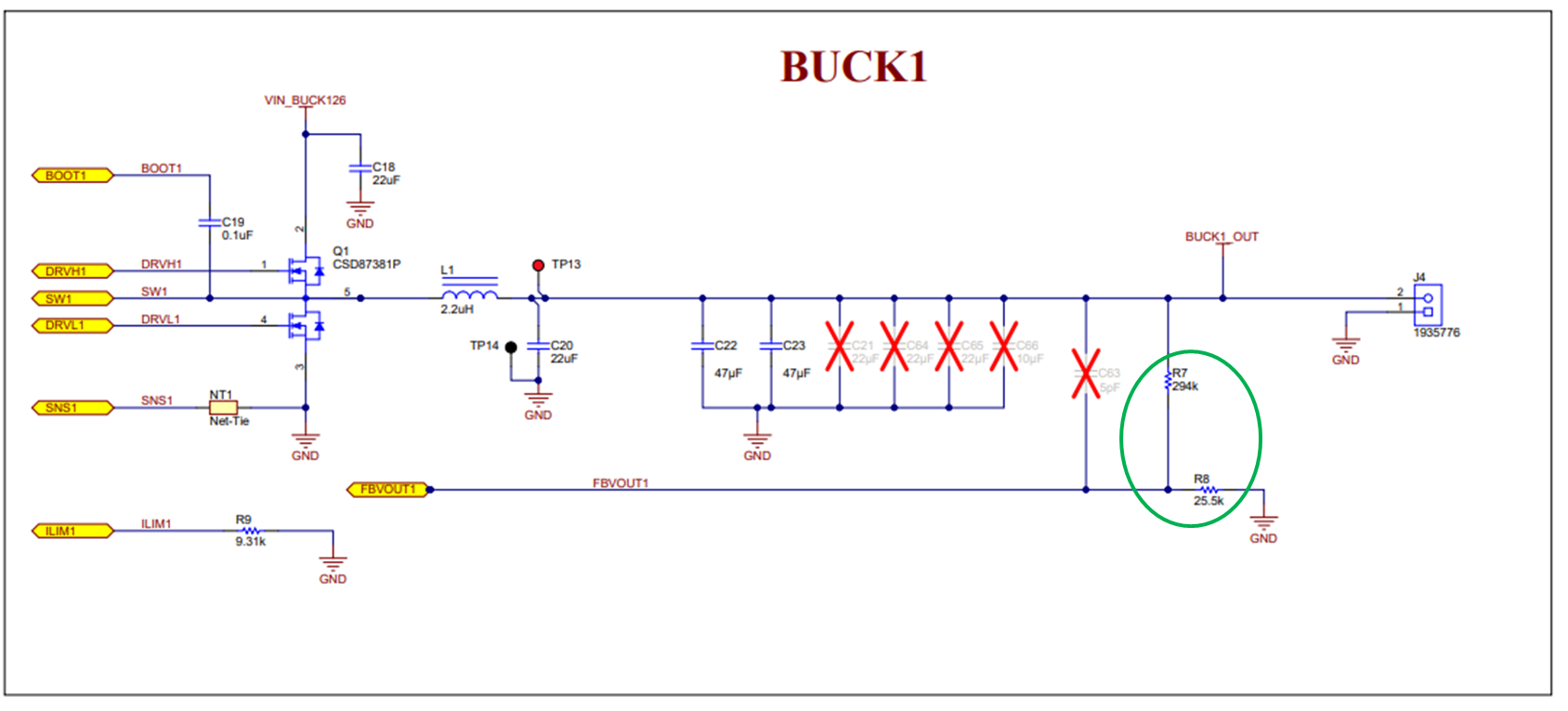

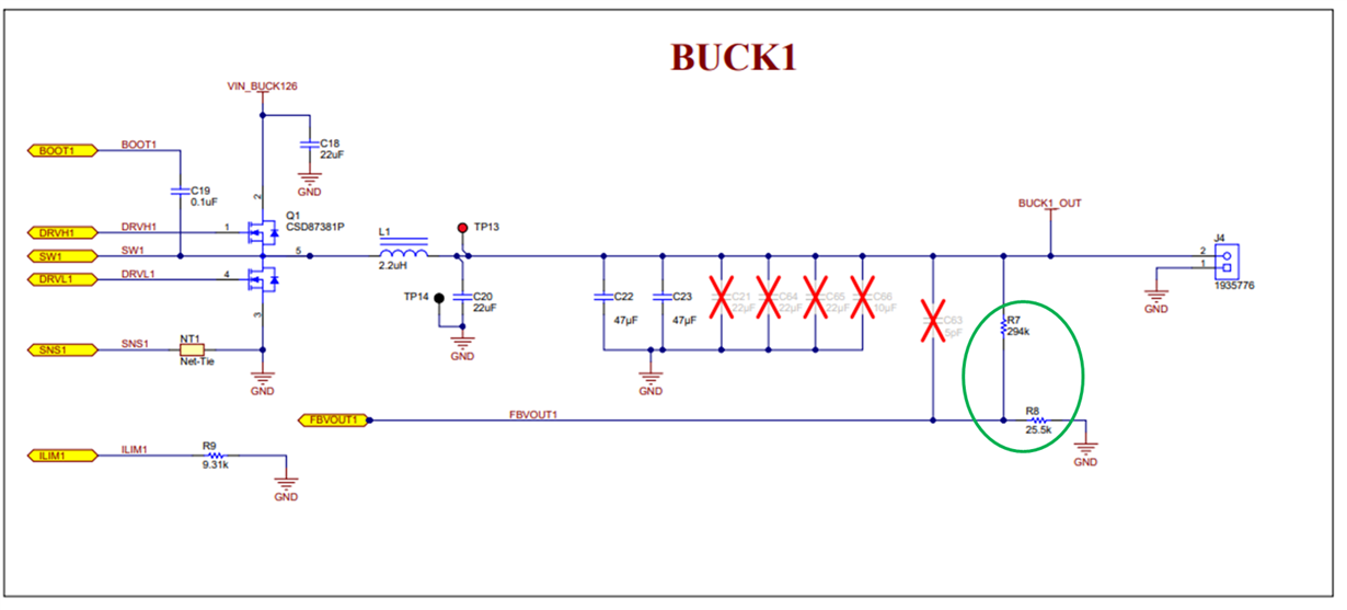

    2. Please Mention the formula to calculate the output voltage of Buck 1

  • Hi Shyam Daram,
    1. To clarify my previous comment about output capacitance, we recommend having a total of 100uF of capacitance on the output of BUCK1/2/6. We recommend achieving this by using multiple 22uF or 47uF capacitors in parallel. Refer to the below screenshot of the schematic of TIDA-01393, a TI design using the TPS650864x family of devices. We recommend using ceramic capacitors.
    2. BUCK1 voltage is determined using external feedback. BUCK1 will regulate to keep the voltage on the feedback pin at 0.4V. To achieve a 5V output, we recommend using a resistor divider consisting of one 294k Ohm resistor and one 25.5k Ohm resistor (294k Ohm resistor connected to the output of BUCK1 and 25.5k Ohm resistor connected to ground).

  • Thanks for your timely answers
    1. Thanks for the info i shall update my SCH for it
    2. please provide the reference for this in datasheet, unfortunately i could not find it directly in any page, please provide page number / recommended feed back resistors

  • Hi Shyam Daram,
    2. Page 37 of the datasheet lists the settings for the TPS6508641 OTP. There is no specific recommendation in the datasheet for that resistor setup, but it can be found in the schematic for the TIDA-01393 design I linked above. The resistor divider can be seen in the green circle in the screen shot below.

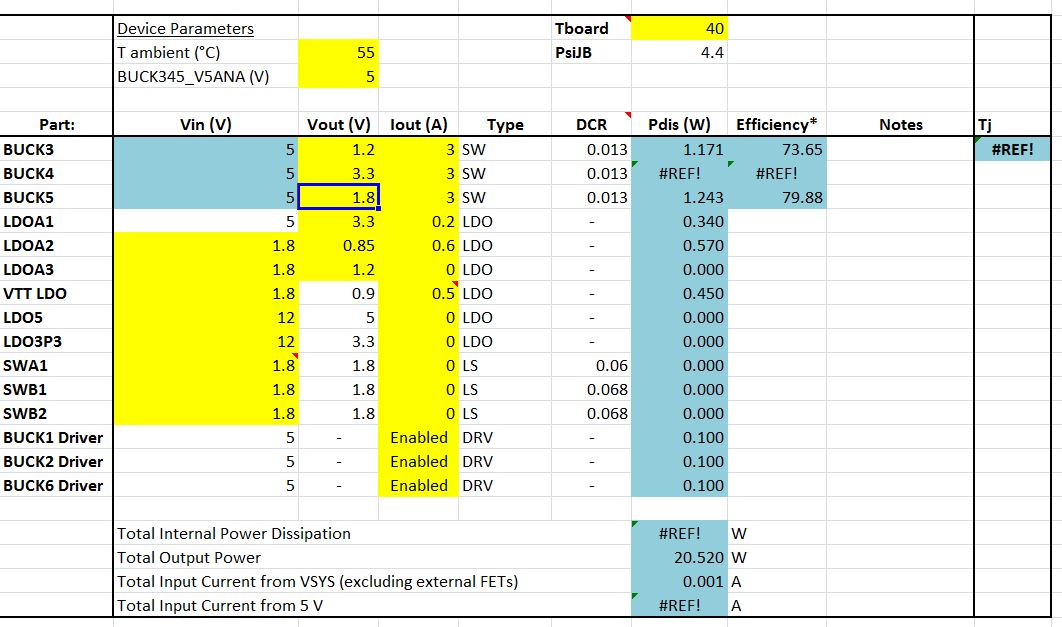

  • Hi Shyam Daram,
    I have attached the power estimation tool.
    Layne JTPS65086 Power Estimation Tool with estimated efficiency option.xlsx
  • Thanks Very much, i have few points to say
    1.  Estimation Seems to fail When Buck 4 output is 3.3V, my schematic strictly follows this
    2. Input for 3,4,5 is ok if it is 5V ? or it should be 5.3 ? as default values entered are 5.3 previously

  • Hi Shyam Daram,
    1. I found a small bug in the back end logic for this spreadsheet. I want to verify my solution for this issue and will post an updated version tomorrow.
    2. Yes a 5V input for those rails is fine.

  • Hi Shyam Daram,
    I have attached the revised version of the power estimation tool. I see you have made all my suggested changes to the schematic. My only comment would be to make sure the I2C pins (CLK and DATA) are pulled up to 1.8V.
    Layne J
    4162.TPS65086 Power Estimation Tool with estimated efficiency option.xlsx
  • Thanks for the update, i have used it and found my worst case consumption would read to Maximum of 20W at an ambient 55dC
