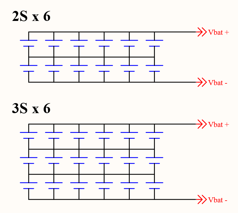

However, we are working on a new product that cannot work on a single cell so we plan to use one of the following configurations.
Each cell is a 3.7V Polymer Lithium Ion.
Protection Requirements:
  • Hibernate mode (prefer wake up on charge like the BQ2980 but it's not the only option)
  • Cell balancing (strong preference for active)
  • Over/under voltage
  • Over/under temperature
  • Over/under current (*1)
  • Short circuit Protection (*1)
*1: we can probably manage current with fuses if we have to.

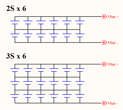

1)
I can see that BQ77915 implements a similar hibernate feature for 3-5 cells.
Will the protection features of the BQ77915 still work for the 3Sx6 configuration illustrated above? e.g. with parallel cells.
In this scenario, the BQ77915 wouldn’t be aware of the individual cells in each row and would see each row as a single cell.
2)
If we decide to go with a 2Sx6 configuration, is there another alternative Battery Protector that will allow us to keep the hibernate and balancing features?
3)
The above questions treat each parallel row as a single cell and connect to the Battery Protector as though it were just a simple 2S or 3S configuration.
How can we implement protection on an individual cell level? I’m not sure if it is necessary, but this E2E thread implies that it is.
4)
BQ77915 provides passive cell balancing. Is it possible to implement active balancing for the 3Sx6 and 2Sx6 configurations?
Kind regards,
  • HI Dan,
    Thank you for your interest in our protection ICs. Please find below my feedback.
    1)
    [David Hien - 2020-01-10]yes. Many (all?) of our customers use our parts with parallel cells
    2)
    [David Hien - 2020-01-10]we do not have a 2s protector IC with the features you mentioned above
    3)
    [David Hien - 2020-01-10]I do not think that it is necessary. I'll check or pass your question along.
    4)
    [David Hien - 2020-01-10]we do not have recent devices with active cell balancing. We have a recent training video here about active cell balancing with some part info.
  • Hi Dan,
    I'm glad you like the BQ2980! As for your questions:
    1. Yes I would suggest the BQ77915 for this application. You are correct, it will see the the parallel cells as one single cell. This is also true for the rest of our devices.
    2. For 2S, your best bet will probably be the BQ2920X family. This product family also supports cell balancing. It does not have a hibernate mode, like the BQ77915, but it does have an Icc of less than 3 uA. The datasheet can be found here:
        1. http://www.ti.com/lit/ds/symlink/bq29200.pdf
    3. I agree with my colleagues on this one. Our devices are not able to monitor the individual cells (unless it was a nS x 1 configuration).
    4. Here is a video that describes the cell balancing features of the https://training.ti.com/how-cell-balancing-feature-works-bq77915. You can configure the Vstep to balance more often, but it is not possible to have the device balance at all times.

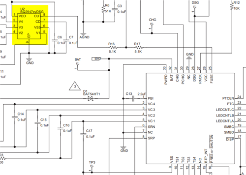

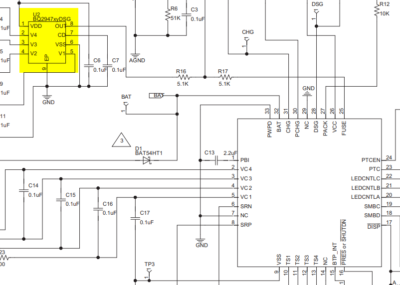

      Typical Application
      Why do both BQ4050 and BQ40z50 need the BQ2947 added when they already have overvoltage protection and monitoring included?
      Page 28 of either datasheet - https://www.ti.com/lit/ds/symlink/bq4050.pdf#page=28
      BQ2947 wouldn't be disabled when the BQ4050 or BQ40z50 are in hibernation. Is this chip necessary?
      Kind regards,

      Typical Application
      Many applications have a requirement for primary and secondary protection for over-voltage. In this case the BQ40z50 would be the primary protection and the BQ2947 is used as a secondary (will trigger at a higher level and blow the fuse in case the BQ40z50 fails).
