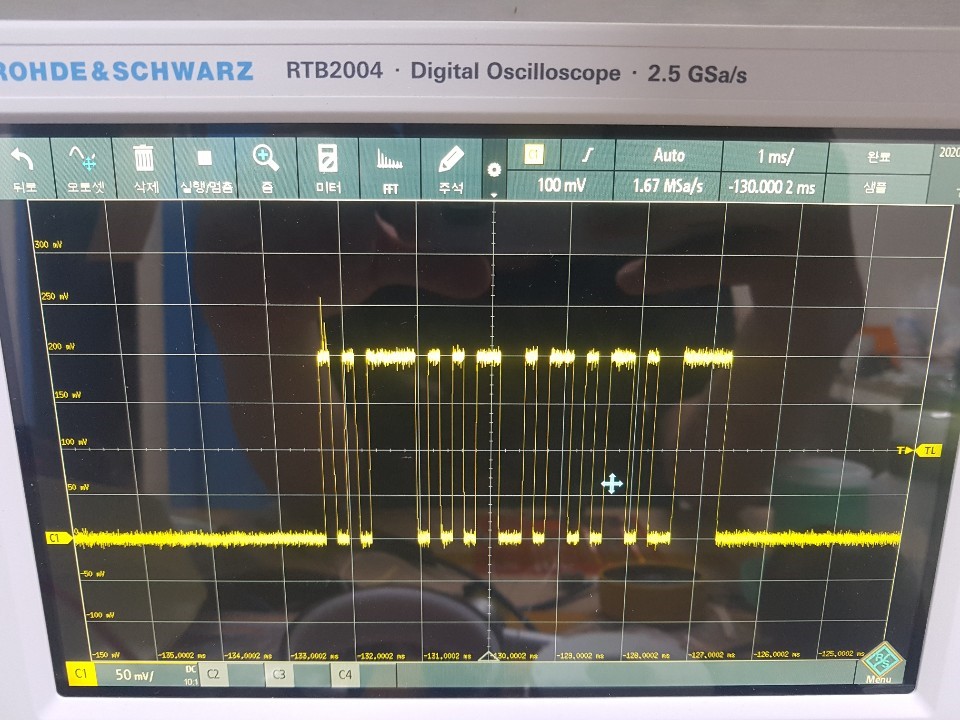

    1. EEPROM measurement
    2 - 1 - 1 - 1 - 2
    Idk what protocol about this, but it seems to be this.
    two messages on first time
    one message on 2, 3, and 4
    and return to first message.
    Voltage is 0.3V and looks like for communication from IC.

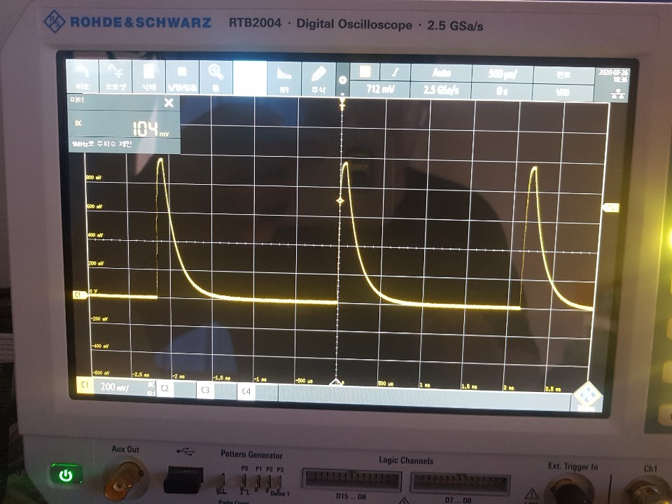

    3. LD measurement
    I measured IC's LD pin.
    Idk how can I analyze this.

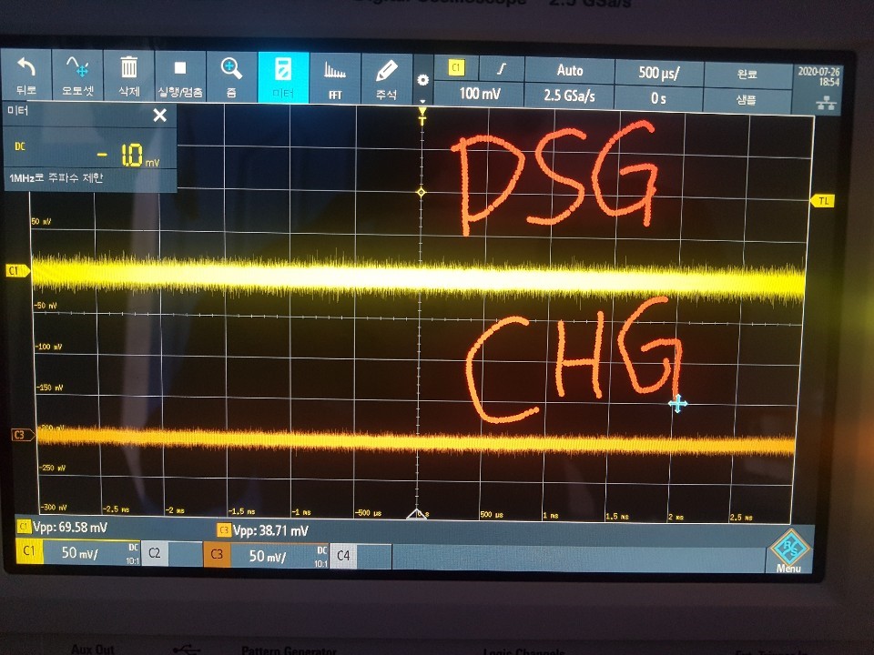

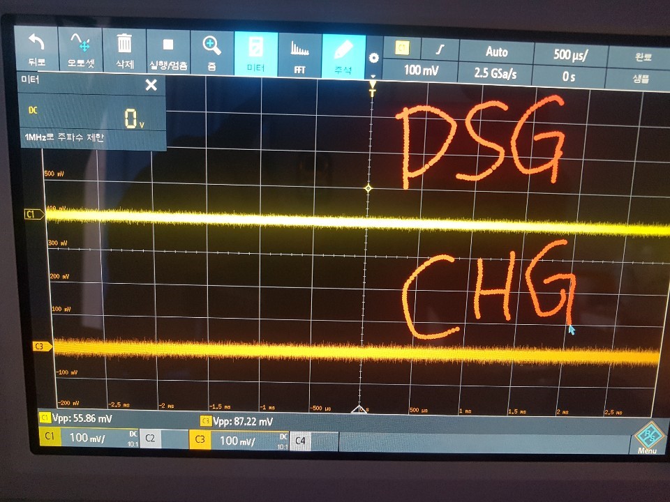

    5. DSG_IC and CHG_IC(Output by IC) measurements
    It looks like not work.
    I saw on datasheet that when PSU supply 18V and if using 200R voltage divider, all FETs are ON
    But I can get only around 50mV each Gate.
    Even I measured on FET side, it looks same.

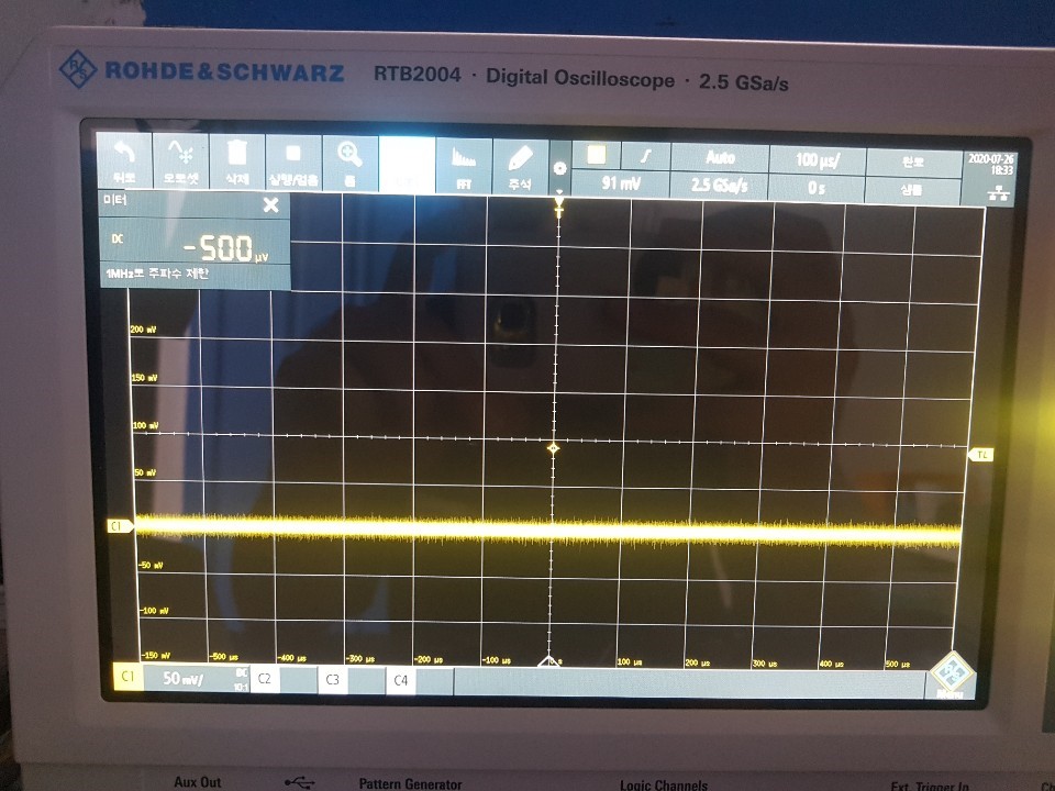

    6. CCFG measurement
    Idk how can I analyze this measurement result.
    It looks like both the CHG and DSG pin are low, which means there is either a open wire, over current, short circuit, or a temperature fault. Please check the conditions of these faults, found in table 9-5 of the datasheet.
    I also noticed the CCFG pin does not look correct. If you are using a 4 cell configuration, the CCFG pin should be tied directly to AVDD (which should be high).
  • My cell config is 5S during the test.

    even I checked datasheet about CCFG, but 5S just have to float them.

    Table 9-5 is going to be the key to debugging your board. First, I would recommend determining the values of the CHG and DSG pins. If both pins are high, there is no fault and your device is operating normally. If either, or both, of these pins is high, use the table to determine which faults could be happening.
    Then, once you have determined the possible faults, check the fault trigger conditions until you determine which fault is occurring.
    Finally, use the the recovery method to return the device to normal mode.
