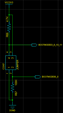

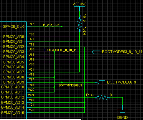

My customer want to optimize BOM and Board size.
So BOOTMOD2_8_10_11 is connected to several boot mode pin.
If only one GPMC_ADn is connected to BOOTMOD2_8_10_11, the current is 0.7mA.
But BOOTMOD2_8_10_11 is connected to 4 GPMC_ADn. the current is 0.17mA.
Would there be any problem?
I think  because input leakage current is 10uA, there are no problem.
What is minimum current?
