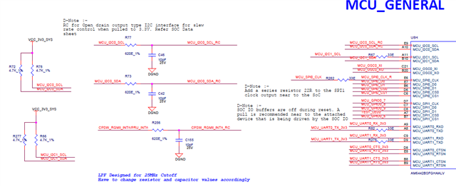

    7. RC delay when open drain output type I2C interface is pulled to 3.3V

    The clock stretching depends on the Bus capacitance.
    In case the measured speed does not match the set I2C speed, verify the I2C clock slew and adjust the slew by varying the pullup on the I2C bus.
