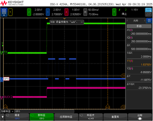

     https://e2e.ti.com/support/power-management-group/power-management/f/power-management-forum/1499036/tps65214-i-want-to-know-the-reason-and-solution-for-this-inability-to-output-normally
    Hello, I am testing the TPS6521402 chip and encountered the following situation during the testing process, which caused the PMIC to fail to start. Can you help analyze the reason?
    ① EN/MODE/VSEL three pins are pulled up to 3.3V with the power supply
    ② The GPO pin is connected to the power supply through a pull-up resistor, but during the power up process, there are three periodic pulses that continue to output a low level
    ③ As a result, BUCK2 outputs 0.8V, while the other power sources do not output voltage
    ④ The above tests were conducted under no-load conditions
    ⑤ Please refer to the test image below for details
    Since PMIC is not able to complete the power cycle, it tried to power up total of 3 times. Are all the necessary output components are populated for all the rails?
    I have already solved this problem. The voltage was pulled down somewhere in BUCK2, causing the feedback of BUCK2 to not meet the requirements, which in turn activated the PMIC protection mechanism, resulting in no output. Thank you very much for your reminder.
