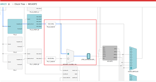

  • Hi Suren
       from am623 TRM, when configure am623 MCASP2  as i2s master, the AUXCLK is the source clock to generate AHCLKX and ACLKX.   I use the k3conf tools to check the AUXCLK , it is  96000000.   Is any method to change the AUXCLK  value ?

  • Hi Suren
      I think I already understand the AUXCLK , from the Clock tree,  AUXCLK  can only choose from hsdiv8 100Mhz or hsdiv6 96Mhz, right?   I change the mcasp2 device tree  assigned-clock-parents  and it take effect

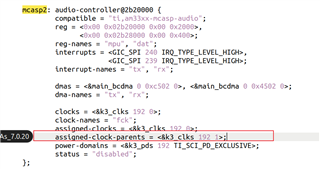

  • hi Suren
    below is my DTS about sound
    mcasp2: audio-controller@2b20000 {
    compatible = "ti,am33xx-mcasp-audio";
    reg = <0x00 0x02b20000 0x00 0x2000>,
    <0x00 0x02b28000 0x00 0x400>;
    reg-names = "mpu", "dat";
    interrupts = <GIC_SPI 240 IRQ_TYPE_LEVEL_HIGH>,
    <GIC_SPI 239 IRQ_TYPE_LEVEL_HIGH>;
    interrupt-names = "tx", "rx";
    dmas = <&main_bcdma 0 0xc502 0>, <&main_bcdma 0 0x4502 0>;
    dma-names = "tx", "rx";
    clocks = <&k3_clks 192 0>;
    clock-names = "fck";
    assigned-clocks = <&k3_clks 192 0>;
    assigned-clock-parents = <&k3_clks 192 2>;
    assigned-clock-rates=<24576000>;
    power-domains = <&k3_pds 192 TI_SCI_PD_EXCLUSIVE>;

    after add assigned-clock-rates=<24576000> to MCASP2 node, I use k3conf to check AUXCLK, it is 24615384, not 24576000. please help check
  • Hi Bert,
    Could you try changing the frequency to another value as the dividers inside the SoC are integer dividers only, not sure dividing 100MHz/96Mhz (Parent clocks for AUXCLK) in order to achieve the 24576000 is correctly divisible.
    But with the existing setup, are you able to play something out on to the codec?
    Suren
  • Could you try changing the frequency to another value as the dividers inside the SoC are integer dividers only, not sure dividing 100MHz/96Mhz (Parent clocks for AUXCLK) in order to achieve the 24576000 is correctly divisible.
       below dts still can not achieve the 24576000
     assigned-clock-parents = <&k3_clks 192 1>;
