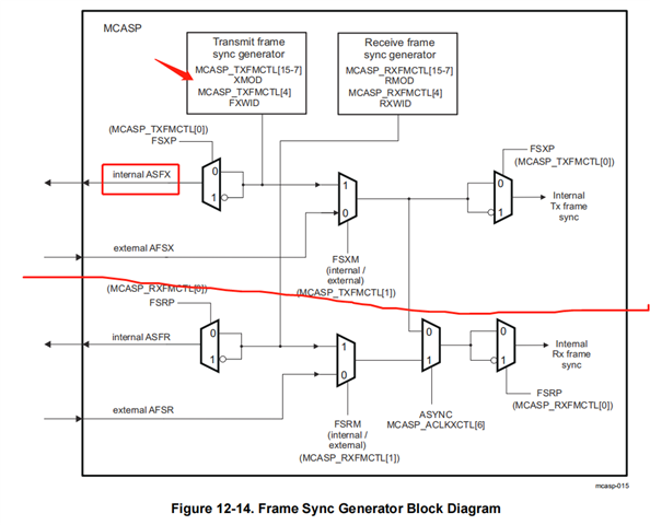

I have reviewed the content of section 12.1.1.3.2.3 Frame-Sync Generator in the TRM (Technical Reference Manual),as shown below,but I'm still unclear about how the frame sync clock is specifically configured.

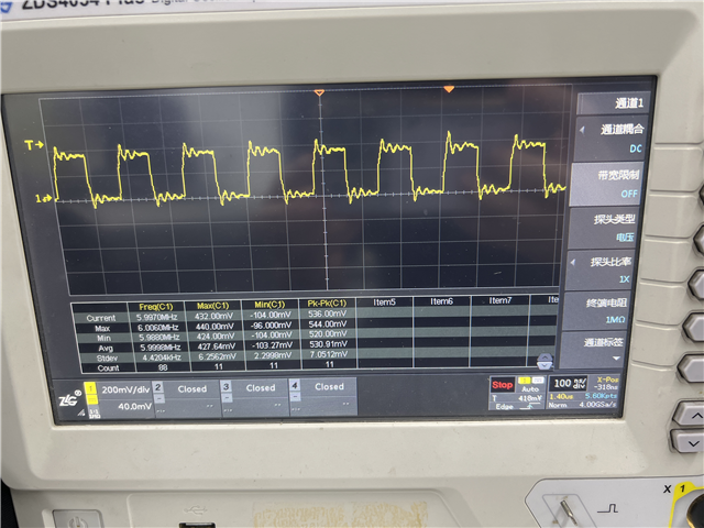

The waveform of the bit clock is shown below:

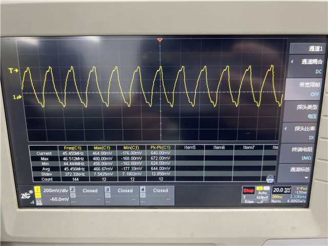

The waveform of the master clock is shown below:
