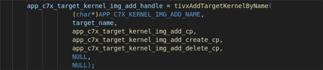

    4. Register and Unregister the Kernel
    Update function names and definitions in both host and target code:
    • Host File    : vision_apps/apps/basic_demos/app_c7x_kernel_cp/app_c7x_kernel_img_add.c
    • Target File : vision_apps/apps/basic_demos/app_c7x_kernel_cp/c7x/app_c7x_target_kernel_img_add.cpp
    Update the following functions with your new kernel name:
    • Host registration
      • vx_status app_c7x_kernel_img_add_register(vx_context context);
      • vx_status app_c7x_kernel_img_add_unregister(vx_context context);
    • Target registration
      • void app_c7x_target_kernel_img_add_register(void);
      • vx_status app_c7x_target_kernel_img_add_unregister(void);
    Rename all instances appropriately (e.g., if your kernel is img_sub, change to app_c7x_kernel_img_sub_register, etc.).
    Update kernel Name from : /vision_apps/apps/basic_demos/app_c7x_kernel_cp/app_c7x_kernel.h
    Change the names of kernel functions in app_c7x_target_kernel_<name>_register and in their function definitions.
