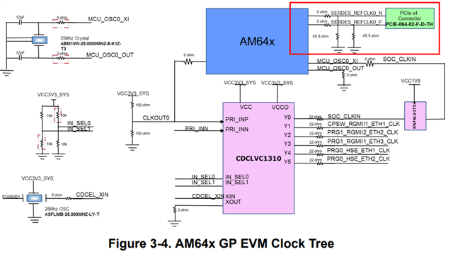

  • Hi
    As I checked AM64x_GP_EVM_User Guide, I could find the similar use case as SERDES_REFCLK (output) is connected to PCIe Connector.
    For this use case, The user guide said the PCIe reference clock to the SoC will be provided by PCIe slot connector when processor is configured as downstream port and PCIe reference clock from SoC(SERDES0_REFCLK0) will be provided to PCIe slot connector during root complex mode of operation.
    If the same approach can be applicable to DRA821U as well, Could you please give more explanation especially about downstream and root complex mode as well? And also clarify the maximum clock speed of SERDES0_REFCLK output to PCIe if the use case is possible. Is it allowed up to 2Ghz over?
  • SERDES_REFCLK can be configured as an output clock.  I do not know the fastest clock the IO can output.  However, for PCIe - while the data may operate up to 2GHz, the PCIe reference clock remains at 100MHz.  Can you clarify why you need to SERDES_REFCLK to operate at 2GHz?
  • Hi Robert
    Thanks for your kind answer.
    Regarding 2Ghz, it would be regarded with data transfer rate....I found it's mentioned on TRM. it's upto 8Gbps per lane.
    PCIE reference clock is 100MHz as you said.
    Thanks for clarification.
