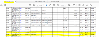

  • Dear Brijesh,
     This is my I2c setting, Is there something wrong?
     Thanks!!

  • Hi David,
    this tells that ub96x is connected over i2c4 lines, but not what is the i2c client address..
    On EVM, we typically use 0x30 or 0x3D addresses, but it really depends on two inputs lines to the ub96x. Depending on these two lines, i2c address is decided.
    Please check your schematic and ub96x data sheet to understand and to know i2c address for ub96x.
    Brijesh

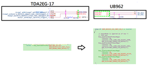

  • Dear Brijesh,
    Q1:
    Our image camera uses the serdes interface
    The receiver of the serdes interface is UB962
    TDA2 used on the circuit diagram is connected to ub962 using i2c4
    The address we use is 0x3d
    "We want to know how to control ub962 through i2c4"
    How to control him through i2c4

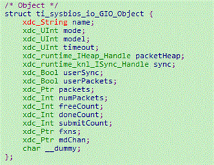

  • Dear Brijesh,
    I'm afraid I didn't explain it carefully enough, so I added something like this picture explain(The text in the picture)
    Or is it related to this parameter, something needs to be registered during initialization?

  • Dear Brijesh,
    I have used Bsp_deviceWrite8 here to get UB96X Version
    According to the first parameter
    Mainly we want to ask
    How to set up the instance i2c and how to connect to the real I2C4 (pre-work)
    Thanks!
    David

    I am looking at bsp_deviceI2c.c Func:Bsp_deviceI2cInit(void)
    The parameters in gBspDevObj.i2cHndl[i2cInstId] , Where is this parameter set?
    and  ioParams.packets = &(gBspDevObj.i2cIomPacket[i2cInstId][0]);
    Why are all the parameters I printed out empty? (Paramters :addr , size ,arg , cmd , status ,misc)
    Thanks!
    David

  • Parameters are set in GIO_construct.
    I would suggest to put breakpoint on this API and see the code flow.
