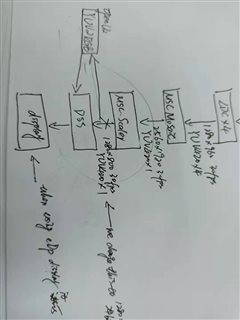

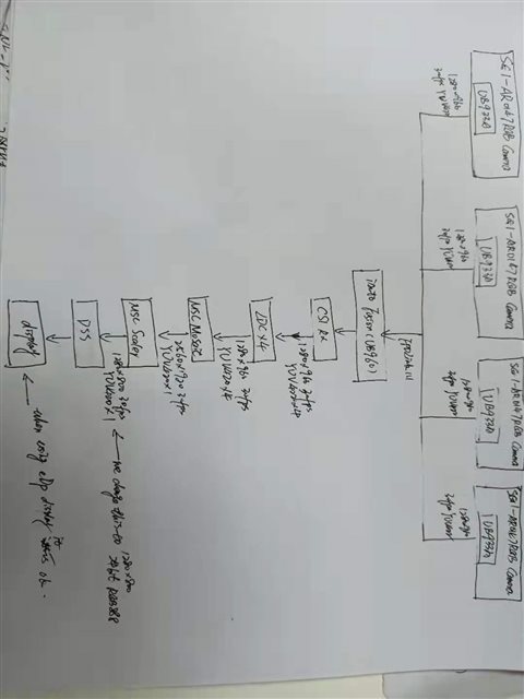

    now i want to use DSI port0 ,  single FDP LINK mode. DSI0->ub941->FPDLINK->ub948. i had change like this:
1.change the file vision_apps/apps/basic_demos/app_tirtos/common/app_cfg_mcu2_0.h
+//define ENABLE_CSI2TX
+#undef ENABLE_DSS_EDP
+#define ENABLE_DSS_DSI
2.change the file vision_apps/modules/src/app_display_module.c
    displayObj->disp_params.outWidth = 1280;
    displayObj->disp_params.outHeight = 800;
    displayObj->disp_params.posX = 0;
    displayObj->disp_params.posY = 0;
3. change the file vision_apps/utils/dss/src/app_dss_j721e.c.keep 941 0x16  i2c config.remove other i2c config. and add some 0x16 i2c config 0x2E i2c config.
   +{0x16,0x5b,0x00,0x5};
   +{0x16,0x56,0x00,0x5};
   +{0x16,0x4f,0x8c,0x5};
   +{0x2E,0x05,0x9E,0x5};
   +{0x2E,0x03,0x78,0x5};
after change above,I found the 948 lock pin is low. so it may be DSI output has something wrong. Is there anyother need to change when use DSI output? thanks a lot.
